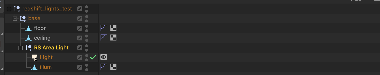

      Visual Examples:
      Plugin creates a building for night view:
      • as long as the plugin is running lights are working
      • a light in code looks like this in a virtual temp_doc:
      • after converting the plugin into geometry (c to make it editable) it converts the lights into this:

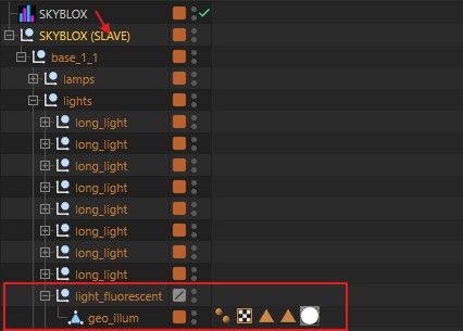

      Plugin Example:
      Here is a trivial plugin example which basically loads a scene and returns an element with a light.
      The scene structure of the document looks like that. The plugin returns the base element

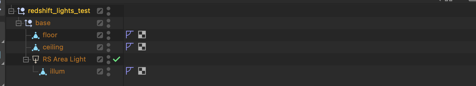

      After making the plugin editabel the light_flurescent is converted into a null object, and not even a Cinema 4D light remains.
      Ideally, of course, the Redshift light would be fully preserved. That makes sense if you want to render with Redshift.

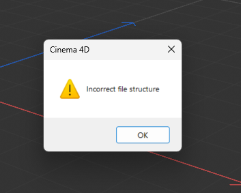

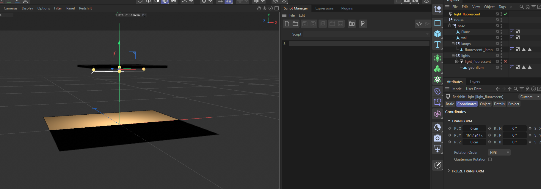

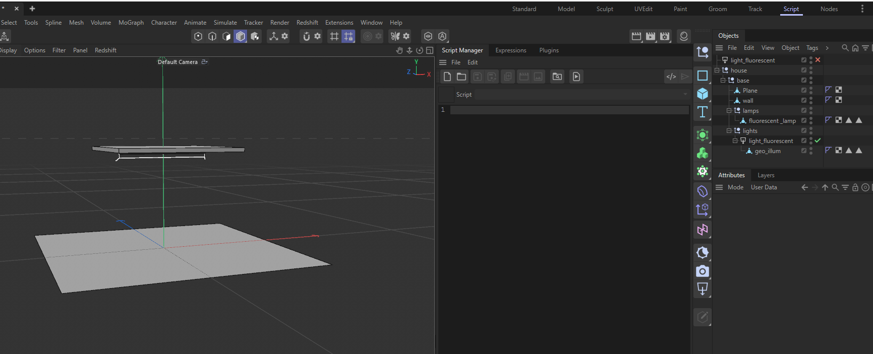

            I do not think that this is an API issue. I do not meant with that that I will not help you, as this still happens in the context of a plugin, I say this simply to classify the issue.
            When I try to manually open your build_1.c4d file, it loads in 2026.2.0 but when I then press C on that light in question, I get exactly the output you report. And I cannot really explain why as this is just a normal rectangle shape area light (well, I sort of can, see below πŸ˜„ ).
            The plot however thickens when I try to open the file with 2026.3.1:
            This file seems to be somehow corrupted. After some poking around I manged to create this build_2.c4d which loads in 2026.3. But the light still did not work correctly. I then created a new RS light instance and copied over the whole data container via Get/SetData, which again resulted in a broken light. Only when I manually recreated the light by manually copying values, I ended up with a valid light. Which then also revealed that this light should have a much different light representation in the VP.
            Your light:
            The manual copy:
            I.e., you seem to have there a fundamentally corrupted scene and especially light objects. The fact that I could reproduce this with a fresh light instance and a Get/SetData copy indicates this the data container of the light is corrupted. We could now start comparing the data containers of your light and the manually created one, to dive deeper, but I think I stop here for now. Did you programmatically modify this scene? Because your plugin only seems to load it. The question is now if you have more scenes like this. Otherwise I would just use my fixed scene (which also contains the fixed light) and move one.

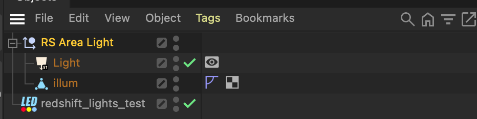

              New scene:
              However, I’ve now created and saved a completely new sceneβ€”exclusively in 2026.3.1β€”and uploaded it as a new plugin. The file cannot be corrupt at this stage. Using the mxutils methods reveals no issues.
              Result:
              However, the result is the same. Something seems to struggle with the conversion process during the "Make Editable" when those lights originate from a loaded virtual document.

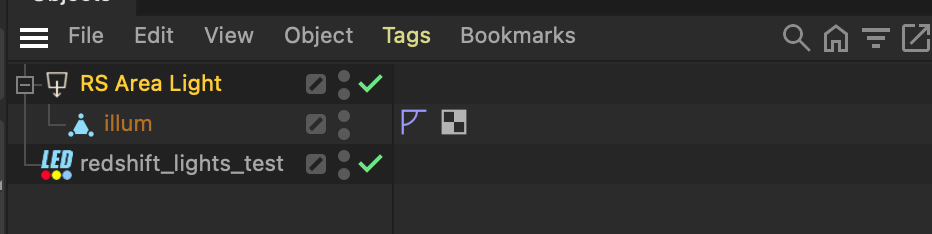

              So, if I create the area light directly via code as you did and then press "C", then it works, it appears in the scene as a standard Redshift Area Light. But you simply can't generate everything via code, so I need the ability to take things from pre-made scenes.
              Important:
              I’ve gone a step further and implemented a button that simply extracts the light from the virtual documentβ€”or rather, the containerβ€”and inserts it into the scene. Oddly enough, the light is inserted correctly into the active document this way.
              The user could bring the lights into the scene before pressing "C"β€”that would be a workaround.
              However, the problem with "Make Editable" still persists.

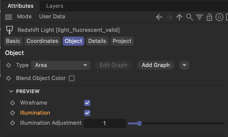

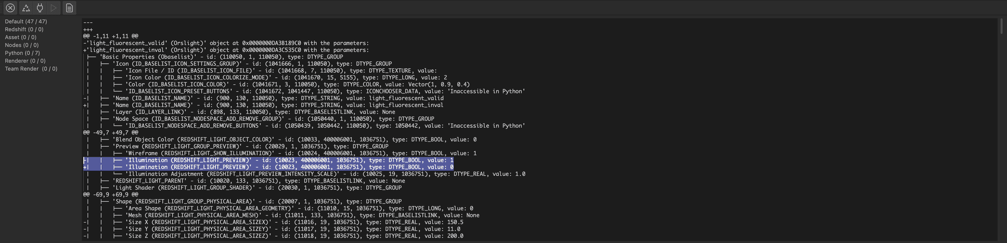

                    so, I had a look and figured it out. When you diff the two objects from my file, there are quite few differences (as I was not 100% faithful in copying all values), but the culprit is this:
                    The RS Light uses a standard light to accomplish its VP representation. When you disable the 'Illumination' checkmark, the RS Light GetVirtualObjects will simply return a null object, i.e., the behavior you experienced. I filed a ticket for this (ITEM#651586 Inconsistent Redshift Light 'Make Editable' behavior), as I would consider this so unintuitive that it borders on a bug. But this is outside of the SDK/Cinema 4D domain, so I cannot just fix it myself.
                    In Python, there is currently no way to fix this on your side. The message MSG_CURRENTSTATE_END is not wrapped for Python (with it you can manipulate the output of a "Make Editable" action before it is inserted). The other route, the build flags on HierarchyHelp are also not possible in Python either, because HierarchyHelp is also not wrapped for Python.
                    But I just changed the latter route, and in the next major update you will be able to react to build flags. There will also be a new code example named py-objectdata_buildflags_2027 which showcases this feature. You can then react to your object being made editable, built for rendering, built for export, etc. and react by changing its output.
                    In your case you would then probably not disable the illumination when your object is being made editable. So, for now, you either have to live with the behavior, or turn on "preview > illumination".
                    Result
                    The output, i.e., diff, with the offending line highlighted.

                      Okay, great that you really dug into this. That could well have something to do with it.
                      However, if you look at my latest test pluginβ€”the C4D sceneβ€”the "Illumination" checkbox on the Redshift light is enabled, yet when you select "Make Editable," the light still turns into just a Null Object. So, regardless of whether the illumination is on or not..
                      But as I mentioned earlier this only happens if the light originates from a temporary document in the code. Or rather, when the scene with the light is loaded into a temp_doc.
                      • e.g. LoadDocument() or MergeDocument()
                      That is why simply checking the "Illumination" box does not work.

                            ferdinand @ThomasB
                            Hey @ThomasB,
                            so I did a clean writing of your plugin demo code in preparation to debug the output and I cannot reproduce the issue you report. For me the light works. There were some issues with your code, but none of them should cause the light to malfunction as your reported on LoadDocument. What you did there with self.container was a bit dicey and could have caused the issue but it seems somewhat unlikely.
                            I am today on my Mac, it seems quite unlikely that this is an OS related issue.
                            The object after pressing the button in your plugin:
                            And the object after collapsing it:

                                ferdinand @ThomasB
                                Hey @ThomasB,
                                my bad, I did miss that. The reason why you are still having problems is that in the scene data you load from your asset file, has generator and scene building flags set on its nodes that are visible in the object manager. When you then put them into the cache of your object, this leads to buggy/unintended behavior, as these flags should not appear in caches.
                                Result
                                The initial state:
                                Collapsing your generator, it now correctly preserves the nested generators:
                                Collapsing once more the RS Light:
                                Code
                                This builds on the cleaned up code example I posted above. But effectively you only need ResetFlags and call it on your cache before you return it. But you should also remove the reference (self.container) to your own cache in your code example from your code, as this could cause some serious issues.
