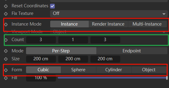

      lanxiang
      I aspire to create a control with a label which follows multiple field switches, selected by the red box, as well as a control with three directional parameter settings. Unfortunately, I am currently unable to achieve it.
      I just implemented above style, so I came to seek help. Python is the one I use.

        Hey @lanxiang I guess you are using *.res file to define the layout.
        For the red part this is the first one is defined like that:
        LONG MGCLONER_VOLUMEINSTANCES_MODE
        	CUSTOMGUI QUICKTABRADIO;
        	CYCLE
        		MGCLONER_VOLUMEINSTANCES_MODE_NONE;
        		MGCLONER_VOLUMEINSTANCES_MODE_RENDERINSTANCE;
        		MGCLONER_VOLUMEINSTANCES_MODE_RENDERMULTIINSTANCE;
        Then based on the value you will need to hide/unhide other elements within the GetDDescription method as shown here.
        The green one is a vector with a step of 1 and its defined like that:
        VECTOR	MG_GRID_RESOLUTION
        	MIN 1;
        	MAX 2000000;
        	STEP 1;
        	OPEN;

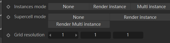

        • L Offline
          lanxiang @m_adam
          @m_adam
          hi,I am very pleased to receive your reply, it is simply amazing. I have already implemented the above function according to your description. In fact, I found that as long as the code you provided is met, this style can be achieved. But QuickTabRadio is not included in the python SDK, which makes me very frustrated. I cannot freely implement the layout I desire. Do you have specific examples of various types of control objects in the *.res file?PixPin_2025-09-24_13-53-32.png
          Thanks for your help again!!!
          Best Regards,
          lanxiang
