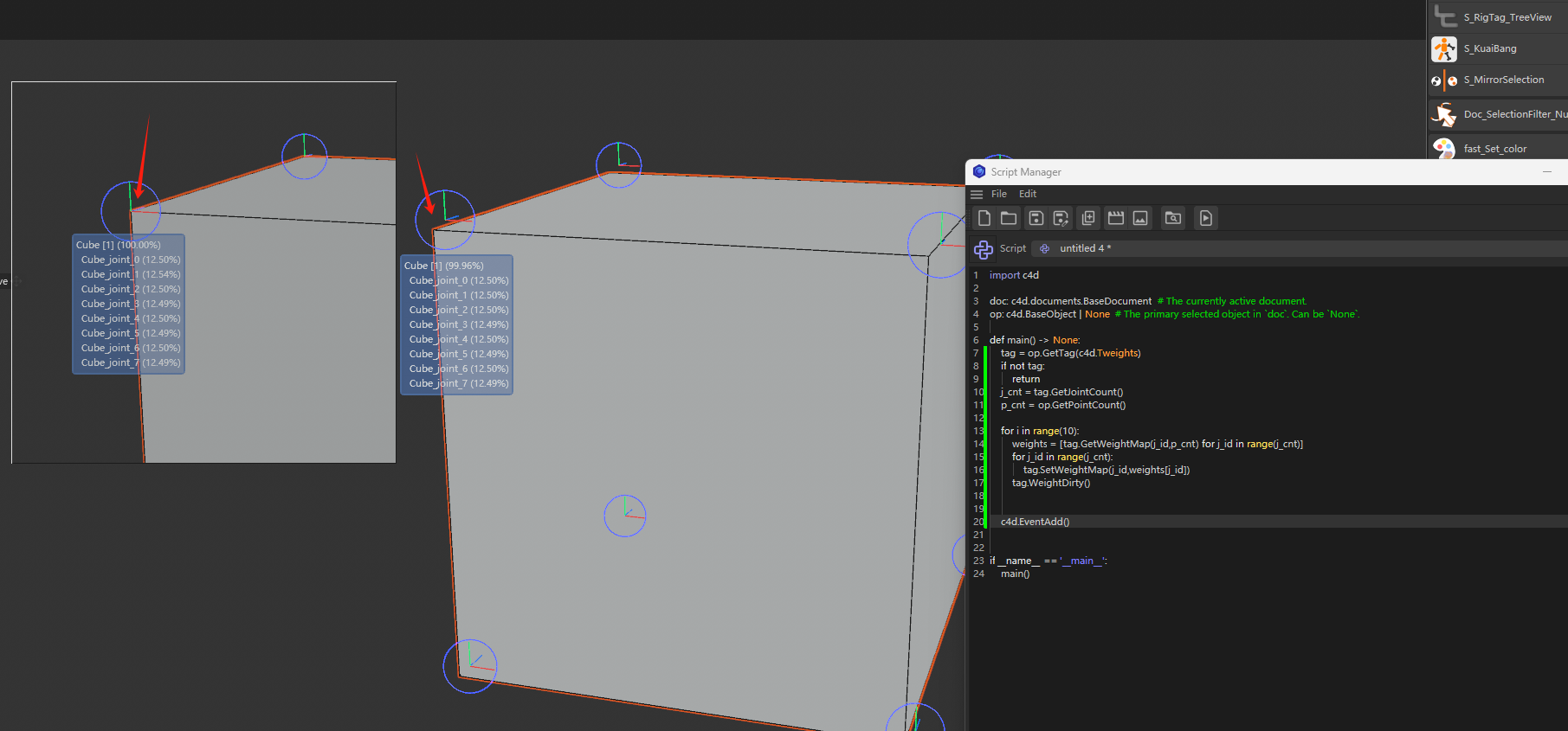

      Previously, I had been using the SetWeight() method to set weight values, and it worked very stably. However, after seeing the deprecation notice for SetWeight() in the python api documentation, I switched to using SetWeightMap() instead. However, there were some issues with this function. When I used SetWeightMap() multiple times to set values, its values would gradually change.
      Below is a simple example of my video, using a standard cube (with 8 points), where each point is equally influenced by all bones.
      However, when I repeatedly obtain the weight values using GetWeightMap()without making any changes, and then set the weights using SetWeightMap() again, I can see that the weight values have undergone slight changes, with the sum of weights changing from 1 --> 0.998

              Hi,The simple demo I made:
              1:Create a standard cube (with 8 vertices),
              2:Create 8 joint (point_id 1 -> joint 1 ),bind it,then offset all joints (x:10000,y:10000,z:10000 cm)
              3:Each point is 100% bound to a bone,
              4: Then, apply smooth 1-2 times to all bones and points to obtain a result where each point is influenced by all bones (facilitating the observation of the code execution results)
              5: normalize weights
              6:Then execute the code 2-3 times, and you can clearly see the result
              code:
                  tag = op.GetTag(c4d.Tweights)
                  if not tag:
                  j_cnt = tag.GetJointCount()
                  p_cnt = op.GetPointCount()
                  for i in range(10):
                      weights = [tag.GetWeightMap(j_id,p_cnt) for j_id in range(j_cnt)]
                      for j_id in range(j_cnt):
                          tag.SetWeightMap(j_id,weights[j_id])
                      tag.WeightDirty()
              video:
              相信我,可以的!

                  • chuanzhenC Offline
                    chuanzhen @ferdinand
                    @ferdinand Hi,
                    I used your file for the demonstration. (Opening your file and running the code directly not cause any issues.)
                    The problem occurred after smooth weights. In the demonstration, only the smoothing operation of weights was performed. Running the code again, you can see the change in the weight values
                    相信我,可以的!
                      ferdinand @chuanzhen
                      Hey @chuanzhen,
                      thanks for the update. I can reproduce the issue.
                      The cause is that some frontend systems can work in a higher precision than the weighting backend can. We use there for some reason UInt16 in the character animation backend to store weights, while the smooth tool for example operates in Float64. Python operates always in 64bit with float. The error is caused by UInt16 normalization (make the value fit into one of the 65535 value bins there are in 16 bit for the range [0, 1]).
                      I did not trace down why this happens not at once but in multiple steps, but the bottom line is that sooner or later weights are forced into a 16 bit format. You as a user cannot do anything about it, but it also is not really an issue. This is not a loss of data, the character weights internally use 16bit. It is more that some of the newer tools built around them provide more precise data than the old character animation core can handle.
                      chuanzhenC 1 Reply Last reply Reply Quote 0
