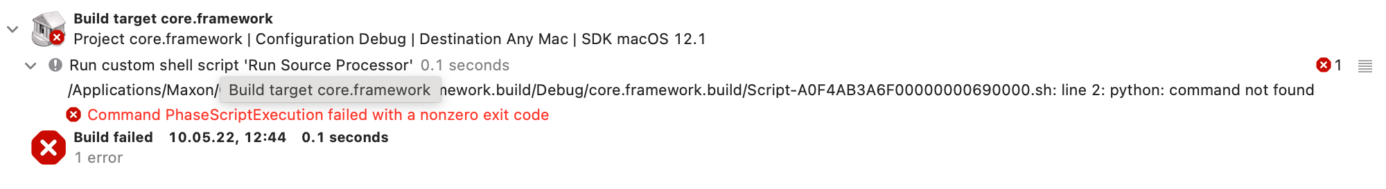

      Today, after some time, I tried to build again, and noticed that all builds (all frameworks, too) fail, because "Run Source Processor" build phase can't run. Supposedly, the "python" command cannot be found:
      I read up on the internet, and it seems that "python" was only for Python 2.x. Why the problem occurs just now, and not earlier, is a mystery to me. Still using Xcode 13.2.1, and still having Python 3.9 and 3.10 installed. Nothing has changed, except that I updated from R25.117 to R25.120, which did not cause any problems on any other machine here.
