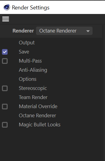

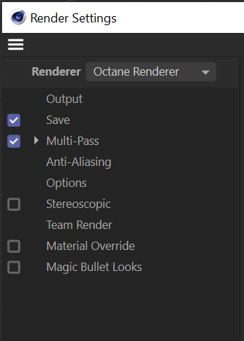

    • 'Octane Renderer' menu settings not appearing when I switch render data to octane with python.
      I am trying to switch the renderer to octane using python, I've achieved this with the following:
      ID_OCTANE_RENDERER = 1036219
      render_data = doc.GetActiveRenderData()
      render_data[c4d.RDATA_RENDERENGINE] = ID_OCTANE_RENDERER
      However if I do this to a fresh document it doesn't seem to initialise some settings. The 'Octane Renderer' menu item doesn't appear unless I switch back and forth to a different renderer manually.
      What I want:
      What I get:
      Is there anything else that happens when you set the renderer manually that I need to account for?
      Thanks
      posted in Cinema 4D SDK windows python 2025
