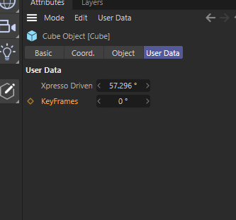

      However, the keyframe does not get inserted:
      What am I doing wrong?
