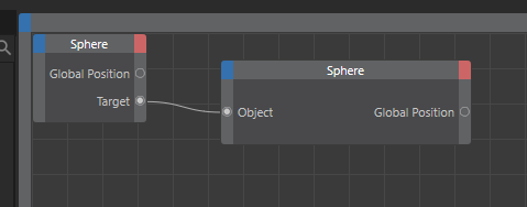

    • Create Xpresso Node with input port Object
      To whom it may concern,
      I am trying to create an Xpresso tag and nodes programmatically with python.
      I can create a Sphere with custom user data, like a link where I will drag another object. I can create the sphere object with output ports for its global position and the link.
      For my application, I need to obtain the global position of the object that will be linked in the link.
      I can create an object node; however, I can not programmatically add the Object Input Port to the object node.
      How is the correct way to add this Input Port Object ? Is there any other way to extract the global position of the link?
      Also, is there a way to set a node name programmatically?
      sphere = c4d.BaseObject(c4d.Osphere)
      doc.InsertObject(sphere)
      ud_target = c4d.GetCustomDataTypeDefault(c4d.DTYPE_BASELISTLINK)
      ud_target[c4d.DESC_NAME] = "Target"
      ud_target[c4d.DESC_ANIMATE] = c4d.DESC_ANIMATE_ON
      sphere.AddUserData(ud_target)
      xtag = c4d.BaseTag(c4d.Texpresso)
      sphere.InsertTag(xtag)
      gv = xtag.GetNodeMaster()
      sphere_node = gv.CreateNode(gv.GetRoot(),c4d.ID_OPERATOR_OBJECT)
      sphere_node[c4d.GV_OBJECT_OBJECT_ID] = sphere
      global_pos_port = sphere_node.AddPort(c4d.GV_PORT_OUTPUT, c4d.ID_BASEOBJECT_GLOBAL_POSITION)
      user_data_container = sphere.GetUserDataContainer()
      target_desc_id = None
      target_port = None
      for desc_id, bc in user_data_container:
         if bc[c4d.DESC_NAME] == "Target":
            target_desc_id = desc_id
            target_port = sphere_node.AddPort(c4d.GV_PORT_OUTPUT, desc_id)
      target_node = gv.CreateNode(gv.GetRoot(), c4d.ID_OPERATOR_OBJECT)
      target_object_input = target_node.AddPort(c4d.GV_PORT_INPUT, c4d.GV_OBJECT_OBJECT_ID)
      What I get with the above code:
      What I need it to do:
      To later link the target with the object.
      Thank you for your time.
      Joel Johera
