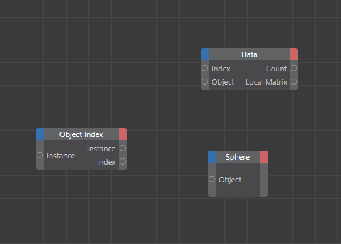

      I get this:

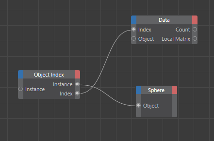

      And I am looking for this:
