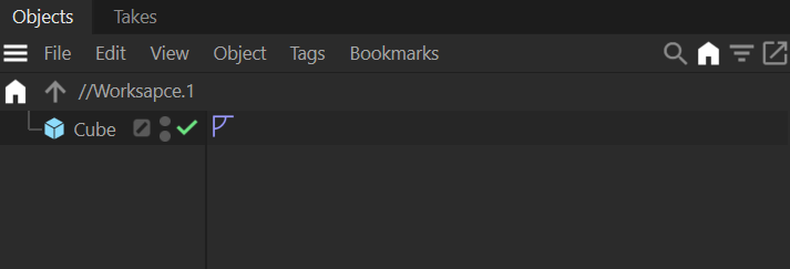

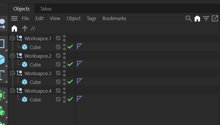

          Thanks for the quick response. To describe my request more specifically, I was wondering if the path bar in an object manager could be used to solo objects. This way I could have multiple nulls containing different parts of the project, then by setting the root of the path bar to a null it would solo the things in that null. This would also mean I'm only seeing the soloed objects in the object manager. That's what I meant by continuity, the object manager and the viewport would have the same content.
          Ultimately, I'm trying to find a workflow that allows for isolating chunks of the project to be worked on one at a time but the basic solo feature is a bit. After doing a bit more research it looks like layers is the way to go. When using layers the solo feature hides the other layers in the viewport and the object manager. If the original idea is still possible I'd be interested, simply because I think it would be a bit more frictionless (no need to add object to layers, soloing tied to object hierarchy, workspaces inside of workspaces). But I understand it's a strange request. I'm comfortable using the standard layers and soloing features for now.

            Well, doing what you want to do is only halfway possible. An object being soloed just means setting the flag EHIDE on all othe objects. And while there is OHIDE which can be used to hide scene elements in managers, e.g., an object in the Object Manager, it is not being used by the 'Set as Root/Path Bar'-function of the Object Manager. So, you cannot hook into that.
            What you can do is just write a simple script which operates both flags for you. But to make this air-tight, you will have to implement a plugin (to avoid accidentally saving a scene with hidden elements).
