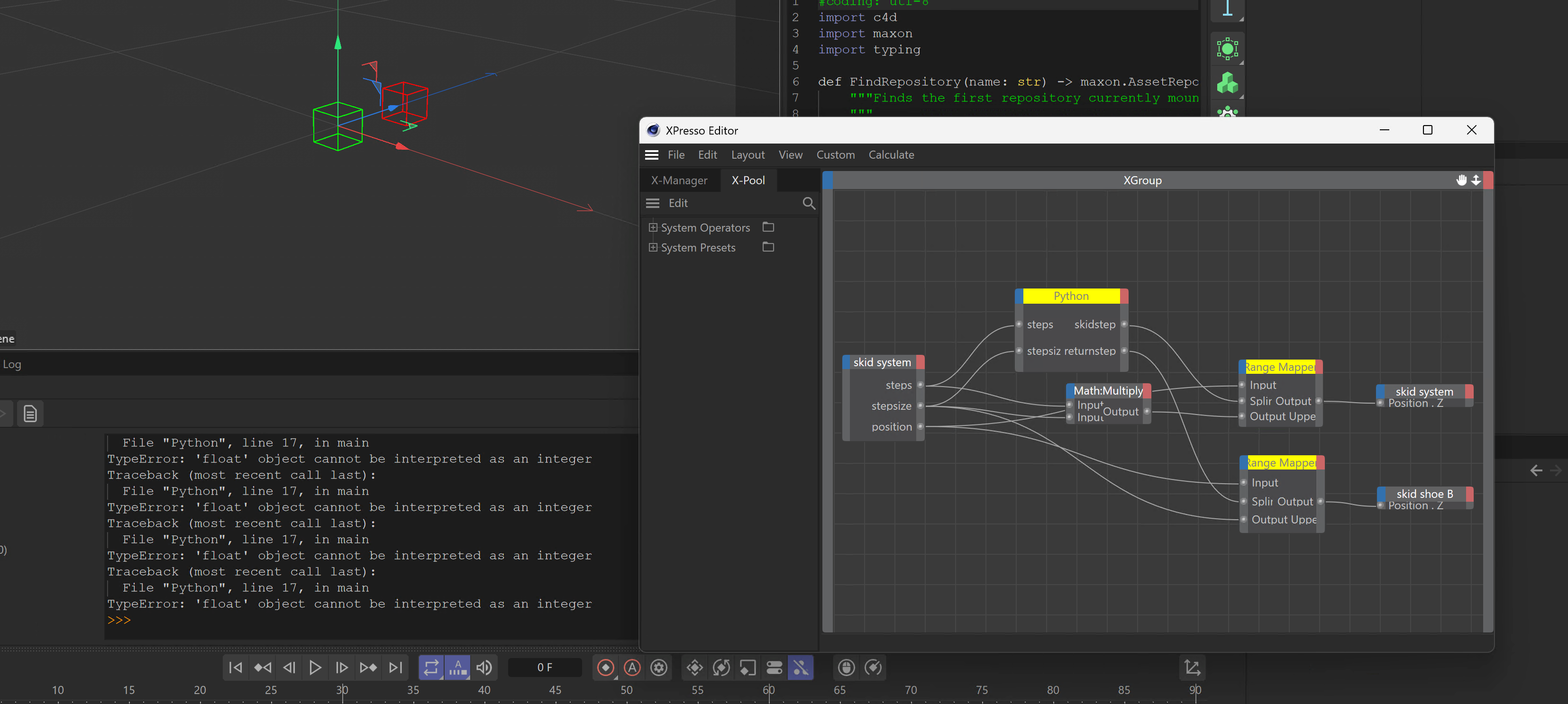

            There are errors in your console, and they tell you exactly what the issue is. Your steps variable is not an integer and MakePointBuffer expects an integer for its number of points.
            Before

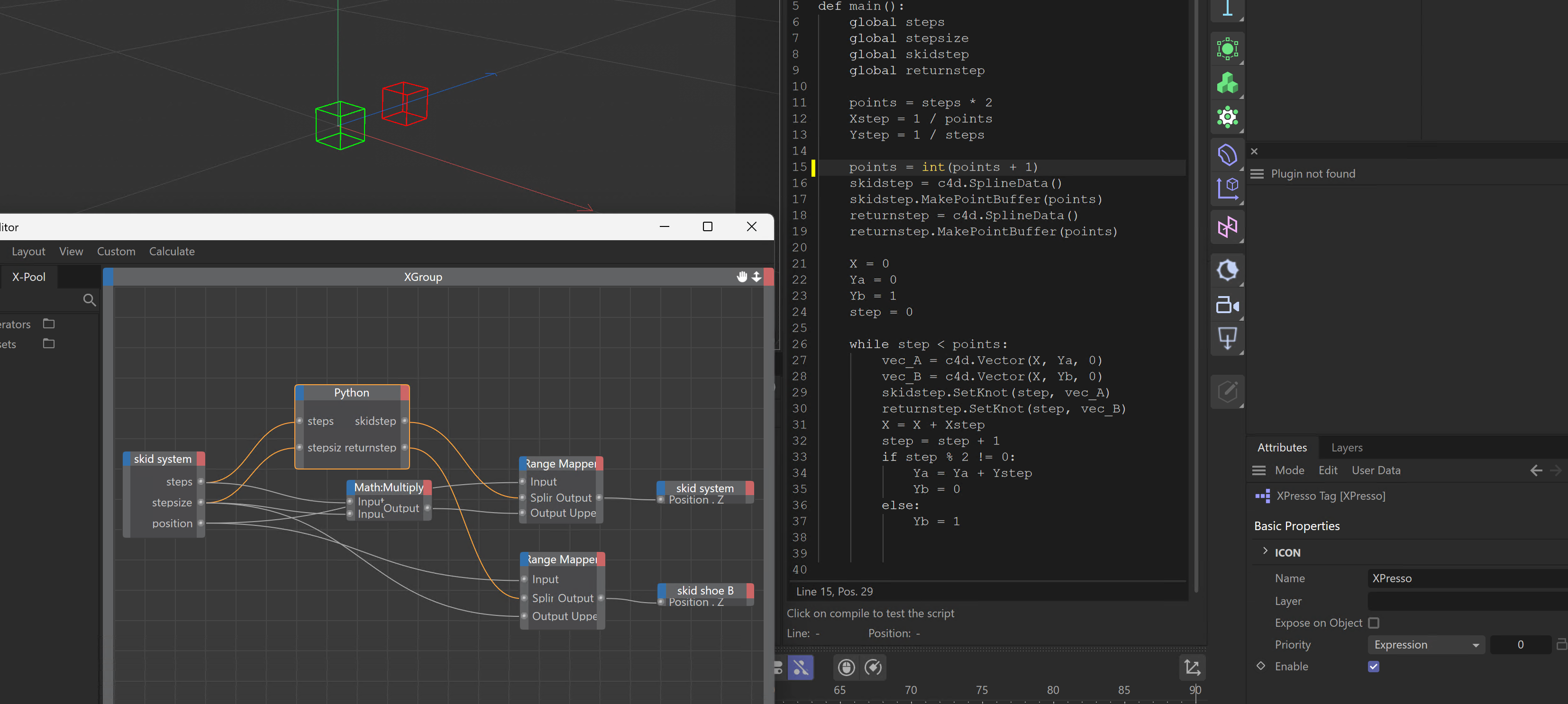

            and after, I just cast points to int:
