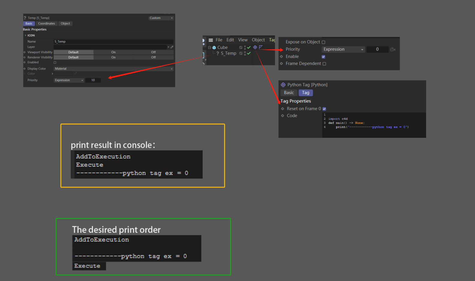

          I added this flag and modified the content of AddToExecution(). Execute() was successfully called, but it did not run in the expected calculation order. In the image below, The Cube object has a Python tag with priority=expression 0 and objectplugin with priority=expression 10. My expected work order should be python tag (priority=expression 0) -> objectplugin (priority=expression 10), but why is the actual running result objectplugin (priority=expression 10) ->python tags (priority=expression 10)

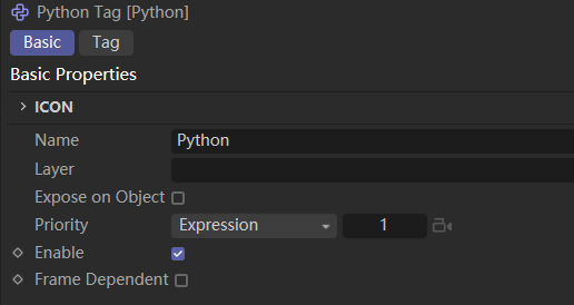

              But there is still a problem. When I used your code and adjusted the priority of **Python tag*to expression 1, the calculation order did not execute as expected. Where exactly is the problem?
