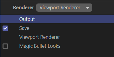

      I am getting the render settings to align and execute however it is not updating the UI. It need to look like this !Untitled-1.png image url) Not this Annotation 2025-01-22 094235.jpg

        First of all, your script strikes me as sourced from or at least written with the help of a chat bot. Please disclose when you use AI, otherwise we might refuse to help you. Please also have a look at Support Procedures: Asking Questions, 'I am getting the render settings to align and execute however it is not updating the UI. It need to look like this !' is not a proper question.
        I am assuming that you want to have similar setup of video post effects in your render data, as if when you choose the Preview Hardware Renderer manually. To achieve that, you must manually curate the effects. You should also avoid using raw integer values when setting parameters, as this leads to confusing code and easily to errors. newRenderData.SetBit(8) #make it selected does for example not do what you think it does. The value 8 is BIT_ENABLEPAINT, but you probably mean here BIT_ACTIVE (2).

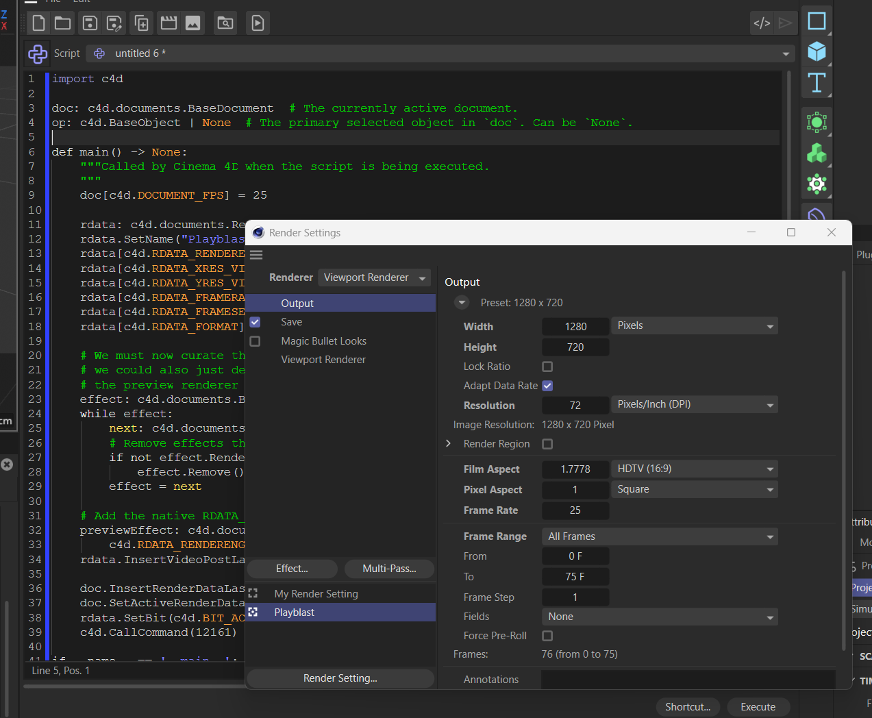

        Result
        Code
            # Set the document FPS.
            doc[c4d.DOCUMENT_FPS] = 25
            # Create a new render data instance with the values you wanted.
            rdata: c4d.documents.RenderData = c4d.documents.RenderData()
            rdata.SetName("Playblast")
            rdata[c4d.RDATA_RENDERENGINE] = c4d.RDATA_RENDERENGINE_PREVIEWHARDWARE
            rdata[c4d.RDATA_XRES_VIRTUAL] = 1920
            rdata[c4d.RDATA_YRES_VIRTUAL] = 1080
            rdata[c4d.RDATA_FRAMERATE] = 25
            rdata[c4d.RDATA_FRAMESEQUENCE] = c4d.RDATA_FRAMESEQUENCE_ALLFRAMES
            rdata[c4d.RDATA_FORMAT] = c4d.FILTER_MOVIE
            # We must now curate the video post effects for this render data. This is probably a bit overkill,
            # we could also just delete all of them, since we know that the Preview Renderer only uses MBL which
            # cannot be removed. But there could be a third party effect which supports the preview renderer
            # and which is present by default, so we do it the proper way by checking each effect for being
            # compatible with the selected render engine.
            effect: c4d.documents.BaseVideoPost = rdata.GetFirstVideoPost()
            while effect:
                nxt: c4d.documents.BaseVideoPost = effect.GetNext()
                if not effect.RenderEngineCheck(c4d.RDATA_RENDERENGINE_PREVIEWHARDWARE):
                    effect.Remove()
                effect = nxt
            # Add the native RDATA_RENDERENGINE_PREVIEWHARDWARE effect.
            previewEffect: c4d.documents.BaseVideoPost = c4d.documents.BaseVideoPost(
            rdata.InsertVideoPostLast(previewEffect)
            # Insert the render data and do the other things you wanted to do.
            doc.InsertRenderDataLast(rdata)
            doc.SetActiveRenderData(rdata)
            rdata.SetBit(c4d.BIT_ACTIVE)
            c4d.CallCommand(12161)

          That is perfect, thank you for being through and concise, lifesaver.
