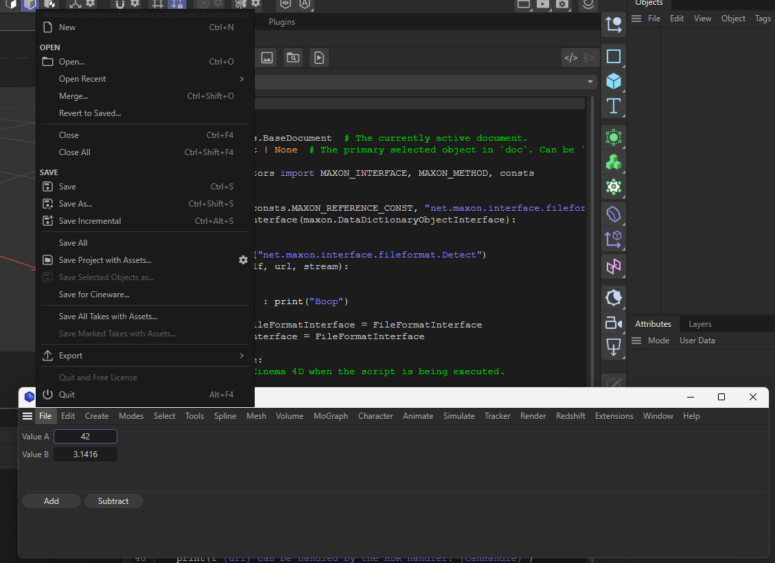

            As in the initial post's screenshot, I'm looking to add an icon next to the menu group (where the green star is in this screenshot):
            Is it possible?

                @zipit I think we're not understanding each other. I want to put an icon to the left of a menu command that has a sub menu. Your GeDialog example's menu commands with icons do not have sub menus. If you go to File > Export and look at the disk icon next to Export (which has a sub menu), THAT is what I want to create in a GeDialog. I hope it's clearer.

                  sorry for taking so long to answer. I do understand your problem now. You want to display the icon on the sub menu header. I have been working on your problem, but my initial solution did not work. I now had a look on how Cinema does it internally, and will try to do this on Monday in Python (with unfortunately no guarantee that this will be possible) .
                  Sorry again for the delay, but I had mostly to settle in here at Maxon this week. Have a nice weekend.
                    Hi @blastframe,
                    I am sorry to inform you, that this is currently not possible. Because the procedures used by Cinema internally cannot be reflected to Python at the moment. We will continue to track this topic internally and inform you here if there are going to be changes and/or we did find an alternative route.

                          It depends a bit on what you mean with 'this'. Loading menu resources still does not seem to work in Python. I just tried, and while loading for example the main menu resource in your plugin just works fine, I cannot make it work with a locally defined plugin resource. Below you can see me loading M_EDITOR, i.e., the main menu resource, into the py-cmd_gui_resources_2024 example.
                          That is probably what I was referring to a bit fuzzily with 'I am sorry to inform you, that this is currently not possible. Because the procedures used by Cinema internally cannot be reflected to Python at the moment.' six years ago. I would have to sit down and debug this piece by piece to see what is going wrong with loading locally defined menu resources (or if I just made a mistake in the resource files). Resources in Cinema 4D are a bit different from plugin resources, and menu resources have never been publicly documented or demonstrated, neither in C++ nor in Python. So, this being broken is not impossible.
                          What you can do right now, is define a string menu item with an icon. But you will not be able to use this to create submenus with an icon as the original question was about. You can only create a string menu item with an icon, but not a submenu with an icon.
