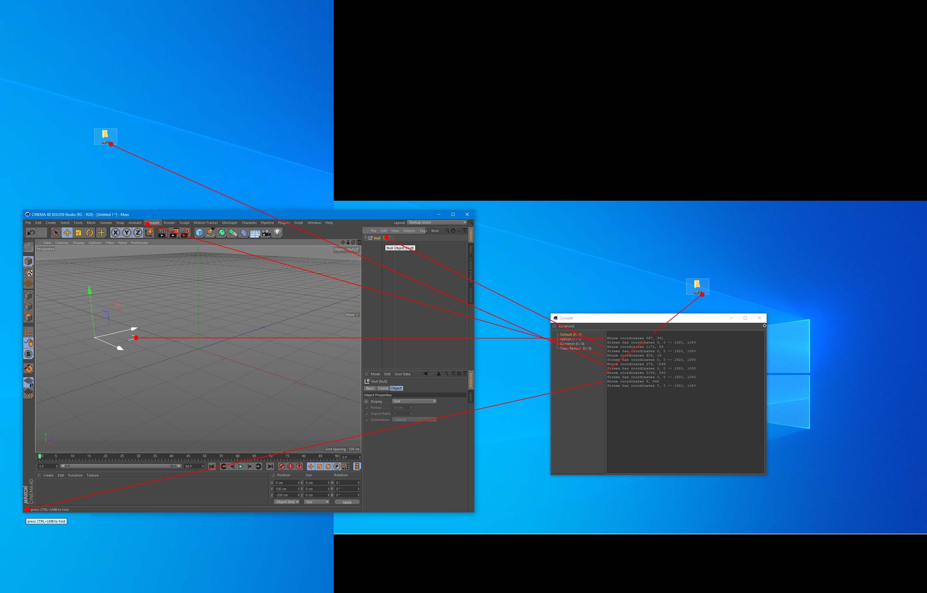

      I am using a multiple monitor setup for testing purposes, as can be seen in following picture:
      The picture isn't that important, but it can help in understanding the next screenshots taken from testing with the above setup.
      I have been running R20 and R21 positioned identically relative to the two monitor setup, and have triggered the plugin with specific mouse positions. Notice that the accuracy of the mouse positions between the two tests isn't that important.

      R20: (had to upload a low quality jpg, better quality png is available on request)
      R21: (same as for R20, a low quality jpg is uploaded for reason of allowed upload size)
      Summary of the test.
      While R20 seems to have appropriate coordinates for mouse positions outside of the main window, the values for R21 do not make any sense.
      However, both version of Cinema4D seem to provide coordinates relative to some reference point of the main window itself. Move the window onto one screen or another, one would expect coordinates to be different, since with GetScreenDimensions the provided coordinates are used to detect the screen dimensions.
      In R20, when the main window of Cinema4D is entirely positioned inside the right side monitor, and the mouse cursor is positioned in the left side monitor area, executing the provided code results in:
      "Screen has coordinates -1080, -650 -> 0, 1270". Which is exactly what one would expect, if the right side monitor is the main monitor with reference corner 0, 0.
      However, move the main Cinema4D window into the left monitor area (entirely or only partially), then with the same mouse position as before one will get:
      "Screen has coordinates 0, 0 -> 1920, 1080". Which definitely does not make any sense.
      So, while the implementation for R20 is "slightly" better than R21, both are useless when it comes to multi monitor setups. I have not tested single monitor setup in details as, to me, it is not an option to have this working with single monitor and not working with multi monitors.
