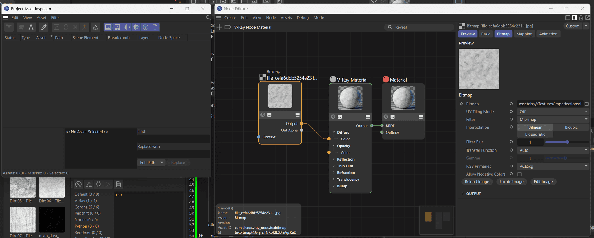

                I had a quick look, and I can confirm that your script does not generate asset inspector output. But at least in 2026.2, VRay does produces any asset inspector output in general. Below is a manually wired up material which should report the asset database texture - but it does not.
                Please contact Chaos about this, they either never implemented what I described above, or there is somewhere a bug in their code or our API. In any case, this can only solved by Chaos Group with possible help from Maxon. You as a user cannot do anything about it.
