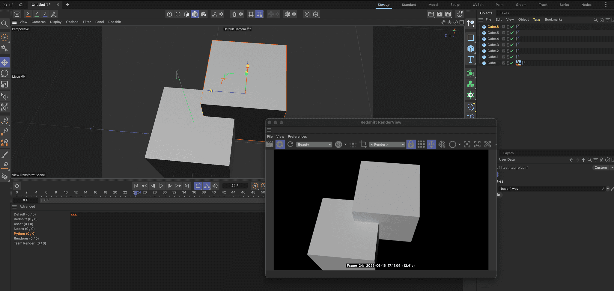

                  Can you provide a bit more context? I tried your plugin on Cinema 4D 2025.2.1 and macOS 26.5.1. I added your tag to a scene, clicked the "Add Audio" button, and started playback.
                  • I experience no slowdowns when I run the scene playback (F8) or the RS render view.
                  • I hear the base_1.wav sound playing your plugin adds.

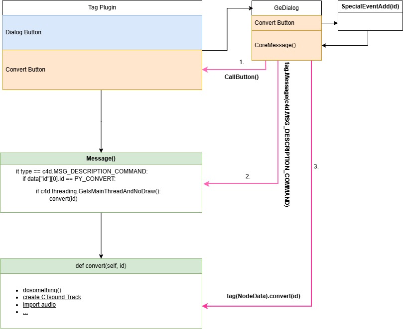

                    Can I trigger the Convert method from within the GeDialog as well?
                    In other words:
                    • when a click occurs in the GeDialog
                    • I send a c4d.SpecialEventAdd()
                    • catch it in the GeDialog's CoreMessage(),
                    • and trigger the tag's convert function.
                    That should put me in the Main Thread, right?
                    • Or can I fire it directly from the GeDialog's Command() method?
                    You can see it in the figure down below.
                    Theoretically, could I use any of the three methods, or is one better? Or am I not allowed to do that at all?
                    Sequence Flow
