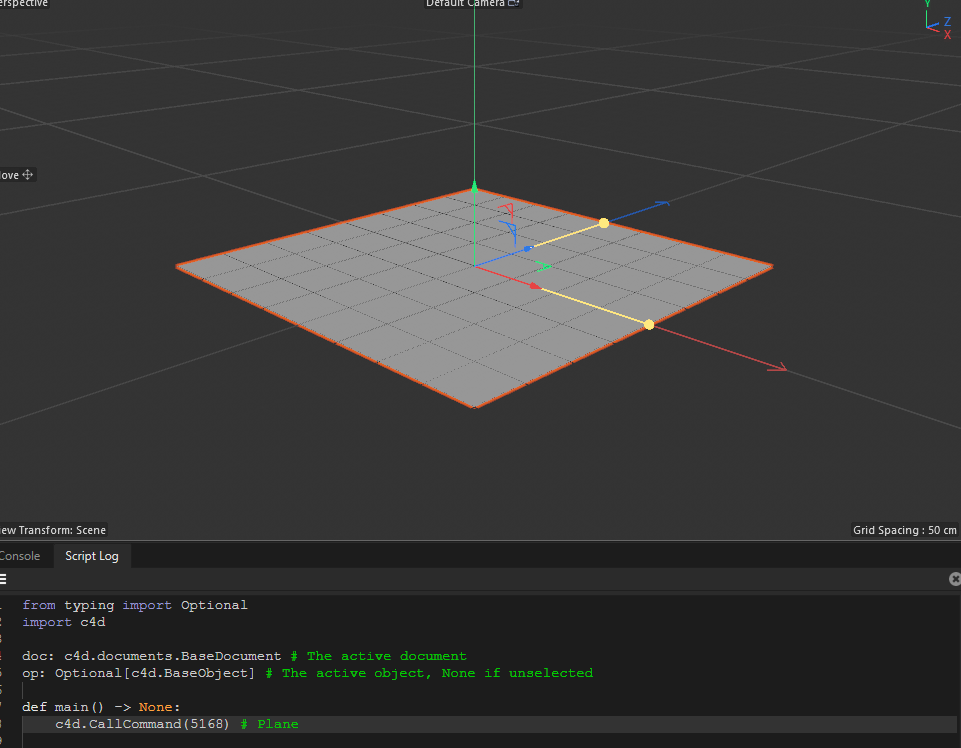

            Almost all buttons and menu entries in Cinema 4D are commands. So, when you for example implement an ObjectData 'Plane' plugin and register it, Cinema 4D will create a hidden CommandData plugin for you, so that this object can be created from a menu. Here shown with the builtin 'Plane' object:

            The script log is just a series of the the commands being called. There are no classes, functions, or methods. In some cases the script log creates more complex code (for tools), but the script log is never a place to learn the API, as it only operates via command IDs. And the script log uses the raw integer values because for once there is not always a symbol, and it would also not be trivial to access the symbol for each command from the C++ code that generates the log.

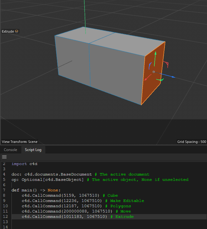

              I've never seen a Call Command with two IDs. What's the common second one ?
              In your screenshot CallCammands have all two IDs. Mine has always one.
                The second ID is the sub ID. You can have a command (FOO = 100) which supports the sub-commands (BAR=1, and BAZ=2). So, you can then call CallCommand(100, 1) or CallCommand(100, 2) to invoke the two different things FOO can do. But as you said yourself, this is a rather unusual thing, and it is even more unusual that I manged to randomly click five things in a row that all have sub IDs 😄
                What should also be said is that my little "extrude" log there does not really reproduce the modelling operations I carried out. It just runs the tools in the order they are invoked. And because when you run this right after your created the log, the extrude tool will for example still have set the same extrude depth from the last operation. But when you manually extrude something, and then run the script again, it will use these new current extrude tool settings, i.e., and not the ones from when your 'recorded' the log.
