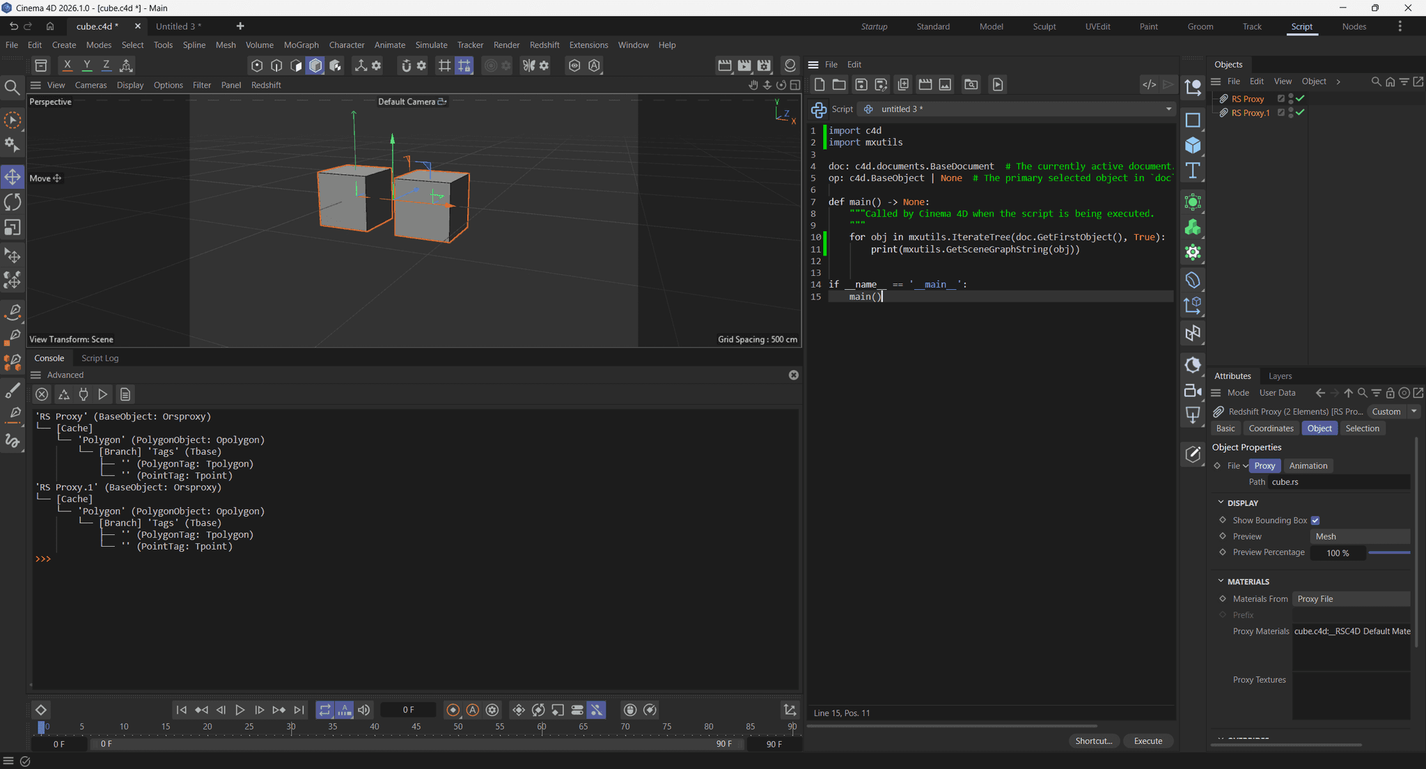

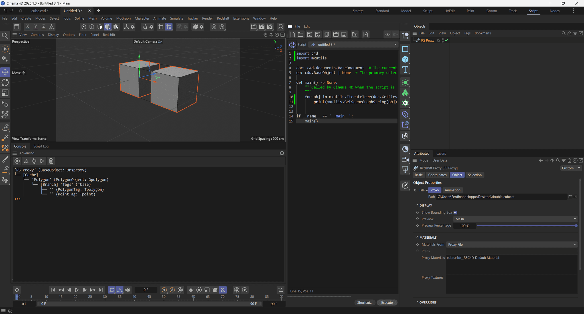

        As an example, when we have this scene which holds two proxies and we run this script on it to, print the scene graph string of each object in the scene, we can see both proxies only hold discrete polygonal data:
        import mxutils
            for obj in mxutils.IterateTree(doc.GetFirstObject(), True):
                print(mxutils.GetSceneGraphString(obj))
        When we now save that scene as an RS scene file and load that in an RS Proxy object in another scene, we will see that it only contains one blob of discrete geometry.
