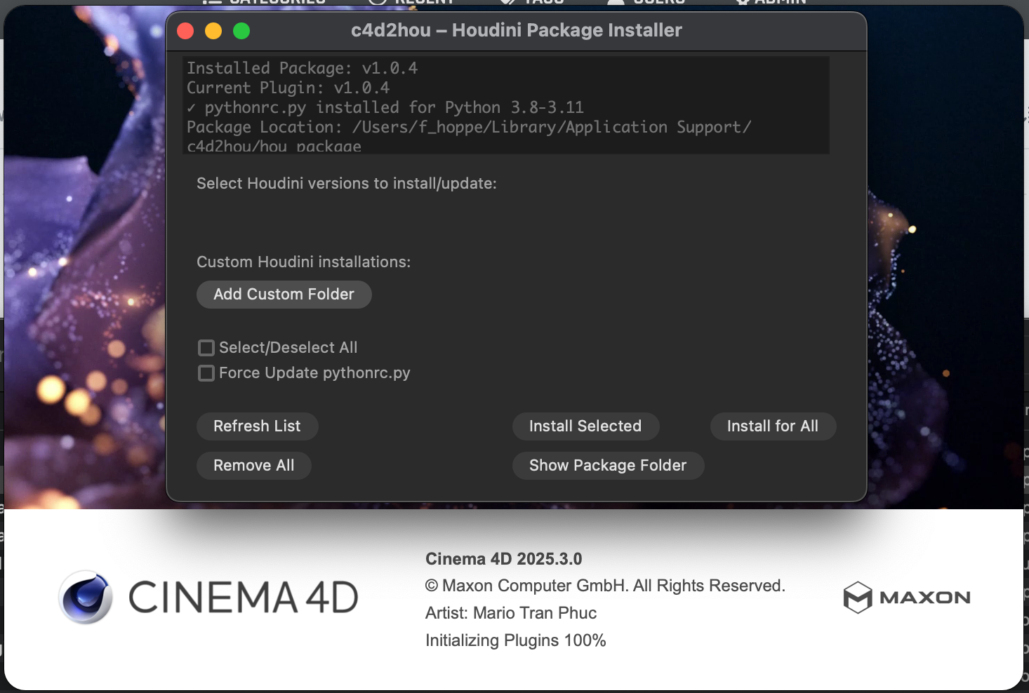

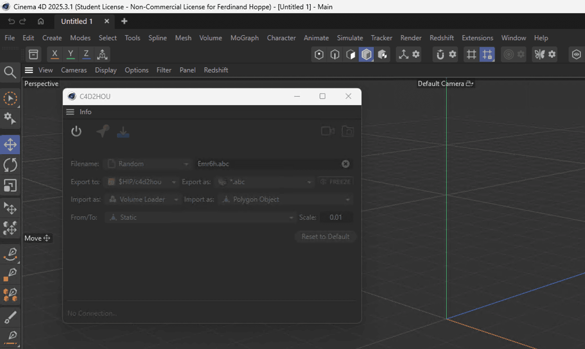

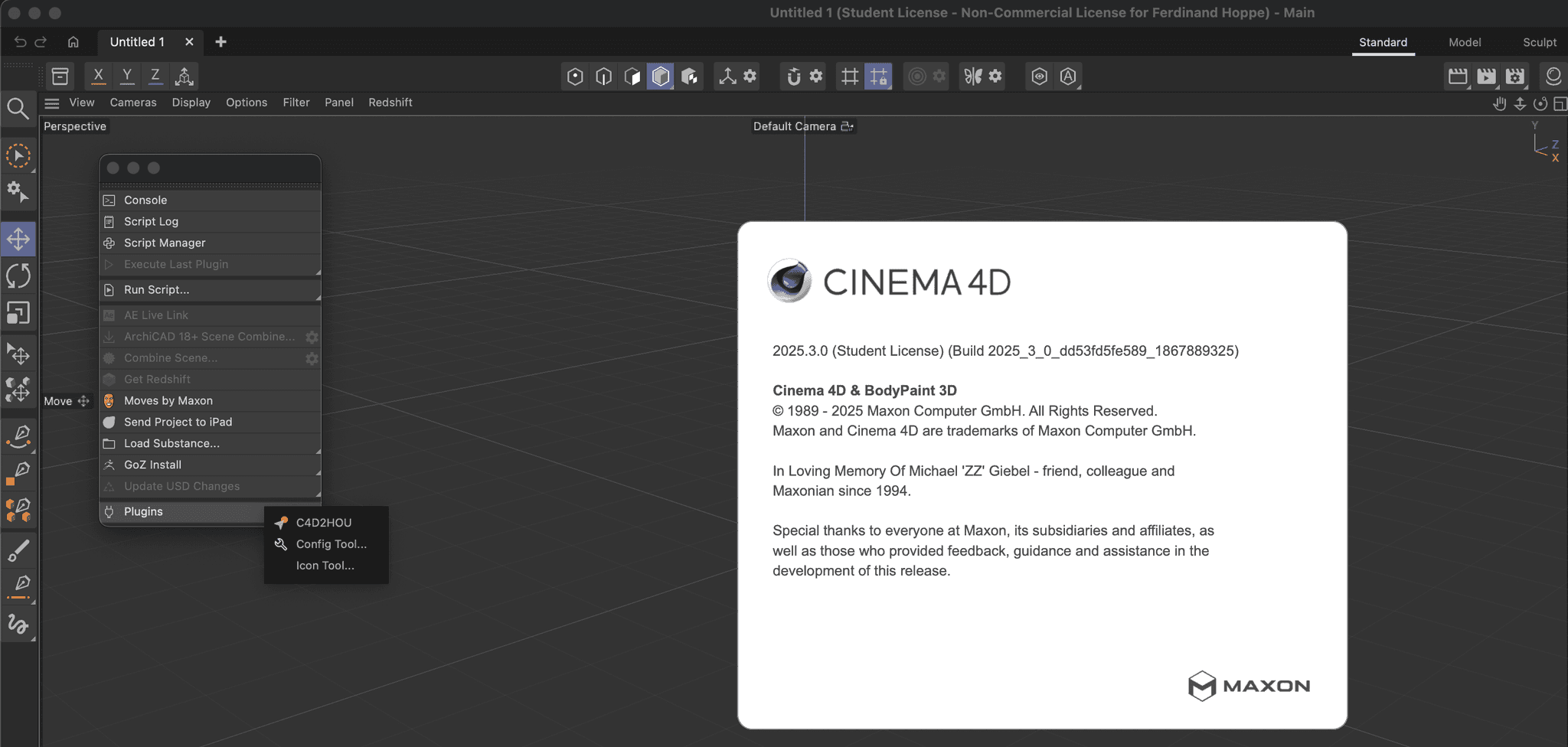

            I tried your plugin in 2025.3.1 (Build 2025_3_1_dec42f629989_1872501510) Win and 2025.3.0 (Build 2025_3_0_dd53fd5fe589_1867889325) OSX (closest version I got on my Mac) with a student license and it just loads fine.

            GUI Operations in Boot Phase
            I noticed that you are creating dialogs and doing file operations while Cinema 4D is booting (i.e., likely within the __name__ == '__main__' context guard of your pyp file). That is absolutely not allowed.
            The registration phase is for registering hooks only. Installing, querying web servers, opening fancy dialogs or doing other shenanigans is absolutely not allowed and can very well lead to malfunctions or crashes. For Python plugins this is less severe as for C++ plugins as Python plugins live in their own fake boot bubble and most systems should have been brought up at this point, but you are still poking the bear.
            We had not too long ago a similar case but for license validation. Register your plugin hook(s) in the boot phase and nothing else. When you have some simple serial or other logic as shown in the serial example, you can run it also, everything else must be done later. Then once Cinema 4D has fully booted (c4d. C4DPL_STARTACTIVITY has been emitted) or when the user tries to use your plugin, you can do a complex license check using web servers or install dependencies. You can then force a restart with c4d.RestartMe.This could absolutely be the cause for the issues of the user and it working on most systems does not mean anything.
            Fig. I: Doing GUI and file operations while Cinema 4D is loading: this is really bad!

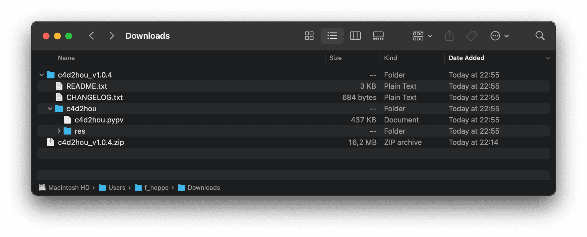

            Nested Plugin Package
            Your download package creates a nested folder, which sort of sets a trap for less experienced users, as linking the outer folder will cause the plugin not to load (due to the limitation of how Python plugins are discovered compared to C++ plugins). I would recommend a flat structure.
            TLDR: I would bet money on the user having linked the wrong folder.

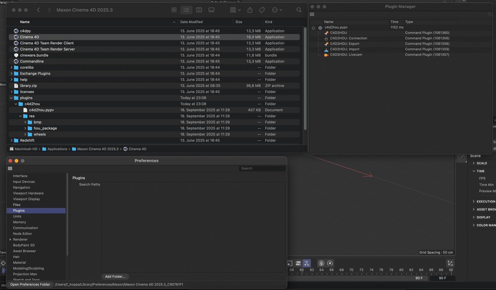

            And just for completeness, here is your plugin loaded from {c4d}/plugins.
