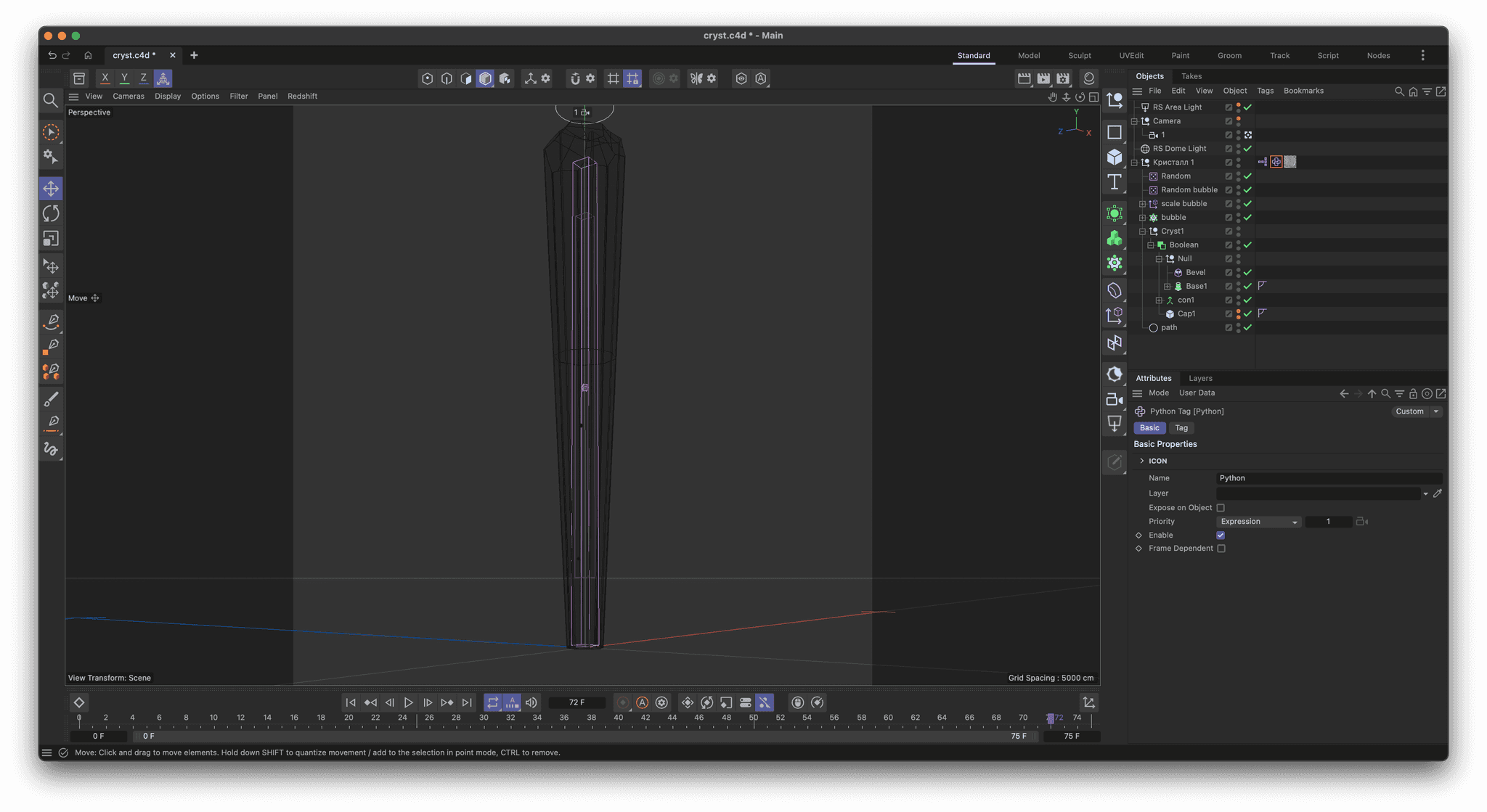

      Hi. Why does the Python tag or Python node in Xpresso crash Cinema 4D and how can I fix it?
      I created a crystal generator project where I use the Python tag to randomly assign generator and spline parameters, and use the Python node in Xpresso to assign the Redshift material(Crystall 1) parameter values ​​(I can't access these parameters via the Python tag). Certain SEED values ​​("Кристалл 1" user data) crash Cinema 4D.
      PROJECT - cryst.c4d

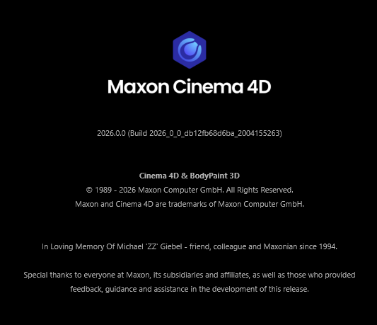

                  @ferdinand Thank you very much for your reply. I currently have the latest version of the program (screenshot).Снимок экрана 2025-10-20 211817.png
                  The program crashes when the cloner is in object mode (circle spline) with cubes placed inside a new Boolean and subtracted from the main geometry( 1st object under boolean).
