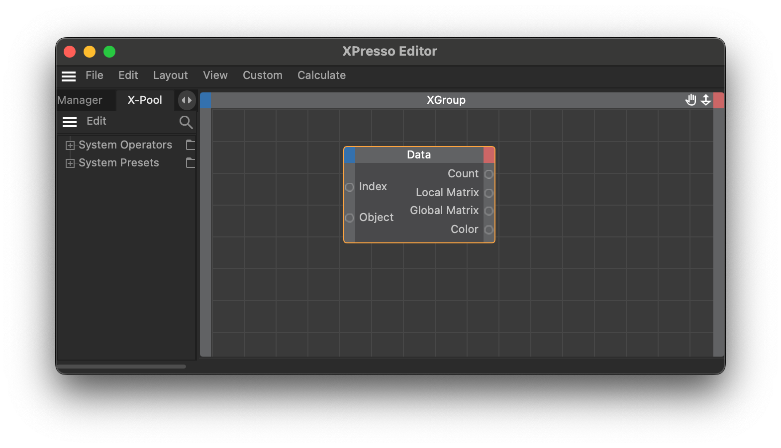

      And the node:
      Also, I am using number 1019010 to create the node as I failed to find the name of the motion graphics data node type in Graph View Node Types.

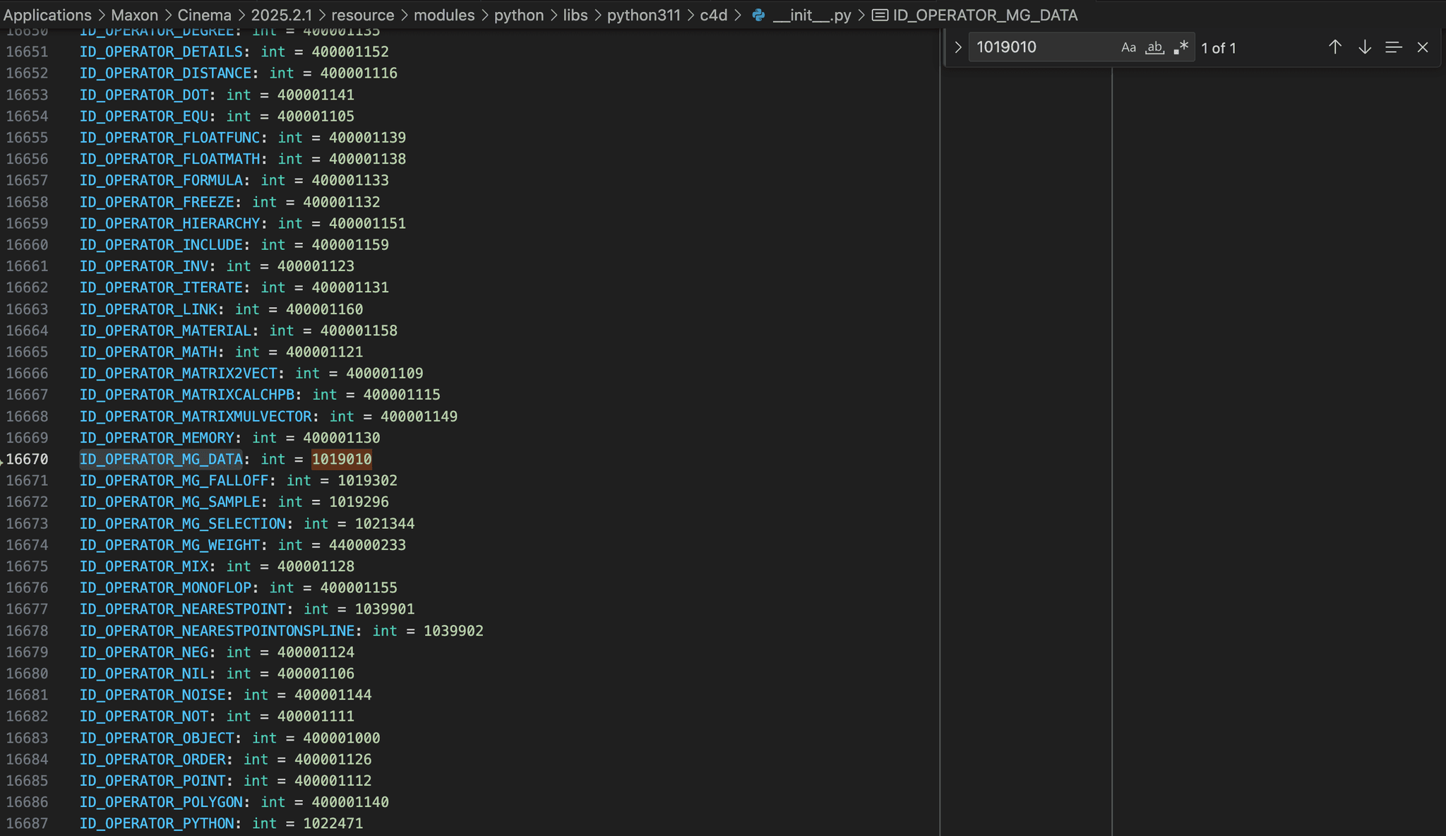

        ferdinand @JoelJohera
        Hey @JoelJohera,
        you are using the wrong symbols you cannot just use the symbols for the object operator. I am not 100% sure what you are trying to do, but I think the symbols you are looking for are GV_MG_DATA_OGMATRIX and GV_MG_DATA_OCOLOR. See Motion Graphics Data for details.
        And you are right about the OP list, the Mograph stuff is missing. That is because this list, other than the rest, is not auto generated and we forgot to add them. I have fixed that for a future release. But that does not mean that the symbols do not exist. You are looking for ID_OPERATOR_MG_DATA.
