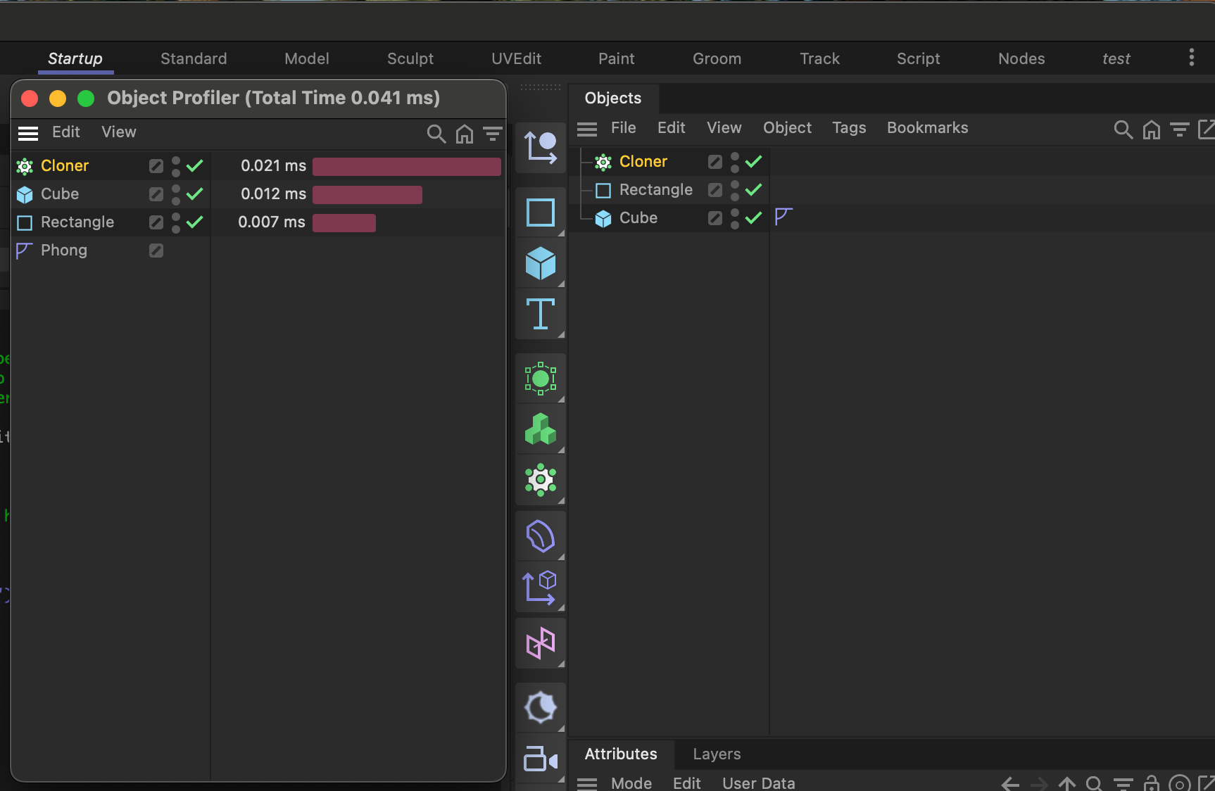

      is there any possibility to debug a slow scene?
      see which generators or other things use what processing time on scene refresh?
      i saw there is a "heat map" for nodes...
      something like this for the scene.
      best, index
        ferdinand @indexofrefraction
        Hey @indexofrefraction,
        Thank you for reaching out to us. The Object Profiler should do what you want to do.
        It is part of Cinema 4D since 2025.0.0.
