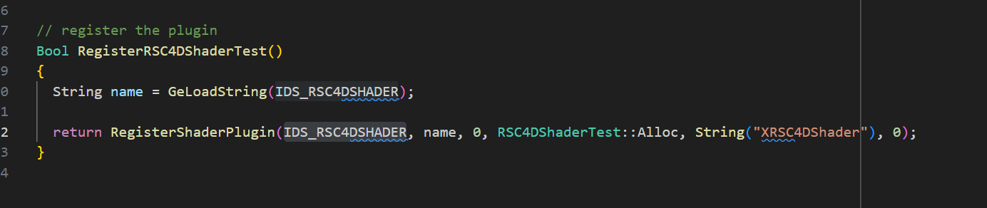

        Please never do something like this, invent plugins IDs and then distribute them, and if you invent a plugin ID for private testing purposes, it is better to invent one after 2 000 000 , because everything below 100 000 is really dangerous, as there are interal types, the current public plugin ID counter is at roughly 1 100 000, and at the end of the Int32 adress space is usded for dynamic command/plugin IDs, i.e., when you give your plugin the ID (INT32_MAX - 1000 - or -3455 , -25, ...), there is a pretty good chance that this will cause issuses or even crashes.
        I have moved this into bugs for now, I will try to rebuild your plugin and then submit a crash report. Because when not your a bit spicey plugin ID is the culprit, this is probably not an SDK issue, but rather something deeper, given your problem description, and your code (which looks fine to me at first glance).

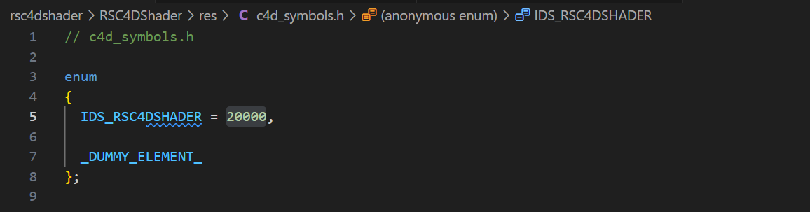

          Firstly, many thanks for looking at this. The plugin ID is a silly mistake on my part (I didn't realise that VS had auto-completed with the wrong ID). It should be ID_RSC4DSHADER (not IDS...) in the register function. If you look in rsc4dshader.h, you'll see it correctly identified with a valid plugin ID there. I was in a bit of a hurry building this and didn't realise what had happened. I'm surprised it ran at all TBH!
