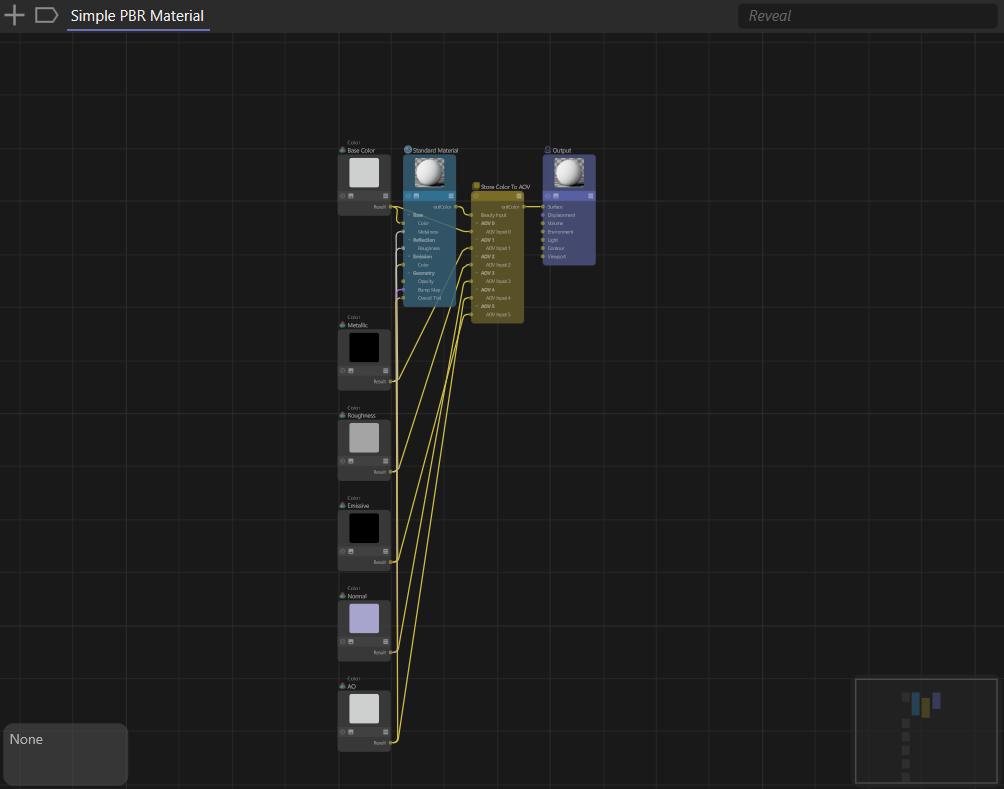

      Hi everyone,
      I am writing a script that scans a Standard Material with existing PBR connections (Base Color, Roughness, etc.) and connects those outputs to a new Store Color To AOV node, based on AOVs already present in the scene.
      The goal is to mirror the current PBR setup to AOV outputs without altering the original material.
      What I am currently unsure about is how to reliably trace the existing PBR connections and wire them to the appropriate input ports of the Store Color To AOV node.
      What would be the recommended approach for this using the 2025 Nodes API?

      On the left is an existing material, and on the right is the result I’m trying to achieve:

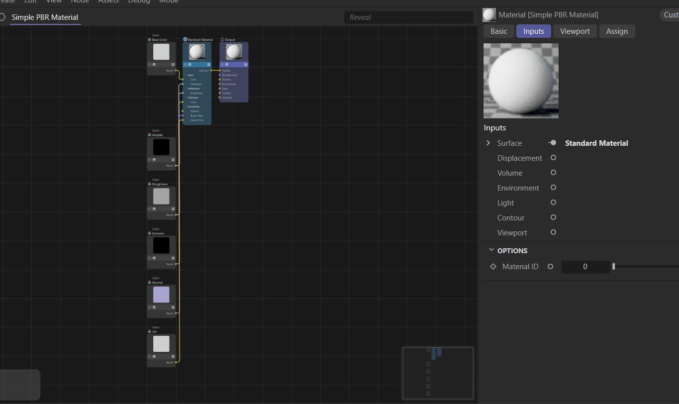

        Hey @itstanthony,
        I am a bit confused. The right side is what your graph description will generate, or am I overlooking some nuance here?
        So, the question is how to generate the left side? Well, you just leave out the "Store Color To AOV" part. I just deleted the lines in your code, which will then give you what you want.

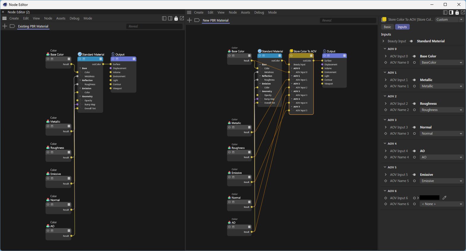

          Hey Ferdinand,
          Thanks again for your help, and apologies if my initial message was unclear.
          The goal is to reproduce the setup shown on the right, starting from the existing material on the left.
          The script I shared earlier builds the whole setup from scratch. What I’m actually trying to do is extend an existing Standard Material graph by generating a Store Color To AOV node that reuses the existing PBR outputs.
          Conceptually it makes sense, but I’m unsure how to best access and reuse those existing PBR outputs on a selected material using the 2025 Nodes API.
          Really appreciate your time and support!
          Anthony

          • ferdinandF
            Hey,
            ah okay, now I understand it. What you will have to do is, use graph queries, so that can get hold of Standard Material and Output node on the right, so that you can rewrite the Output node, to that it does connect directly to the material. I do not have that much time right now, I will answer in more detail latest by the end of the next week.
