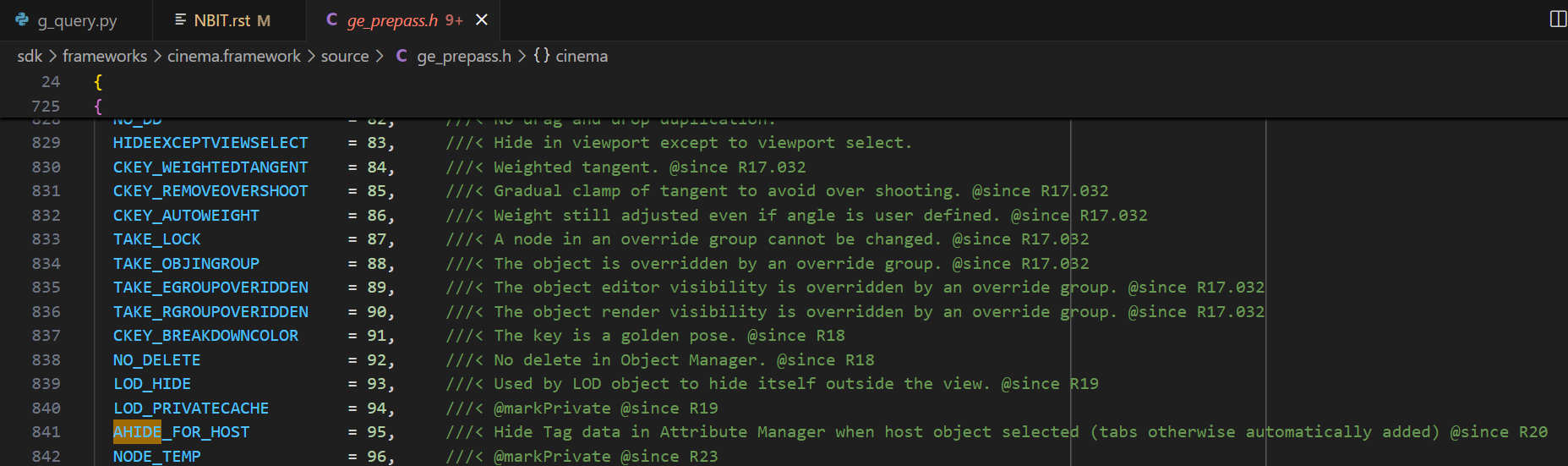

        Thank you for reaching out to us. The module attribute is NBIT_AHIDE_FOR_HOST. The line there in the docs might have been written when we still exposed symbols manually (and were a little bit inconsistent - these days symbols are exposed automatically) or always has been incorrect. But our documentation is still managed manually, something I probably should change, but that will also cost time.
        When unsure, you can always search {c4d}\resource\modules\python\libs\python311\c4d\__init__.py, as this is where all the c4d symbols are defined. Or you just search {c4d}\resource\modules\python\libs\python311\ and with that the whole API. Last but not least, symbols are always just that - symbols - and you can also just use the raw value directly lifted from the C++ API frameworks (when something has not correctly been exposed for some reason). That would have been 95 in this case:
        I have updated the Python docs for this member of NBIT to be named as c4d.NBIT_AHIDE_FOR_HOST.
