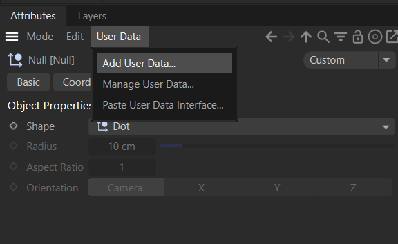

          |I am not familiar with the "user data editor". I am interested in changing the settings because this is what it looks like now:
          I would like it to look like this - including the ability to fold it
            ferdinand @ECHekman
            Hey @ECHekman,
            well, I was talking about User Data, as they can be a nice way to inspect what data types and their custom GUIs can do.
            For what you want to do, this will however not help, as there are only the description settings listed, which necessarily do not have to be all settings there are. To start with an expanded GUI, you must set LAYOUTMODE_MAXIMIZED. I think the little toggle arrows are not supported in dialogs, but I might be wrong. When you want to know more about the little toggle arrow, I would suggest to write us a mail, so that I can forward it to a GUI specialist, as I do not know if and how you could make the arrow work.
