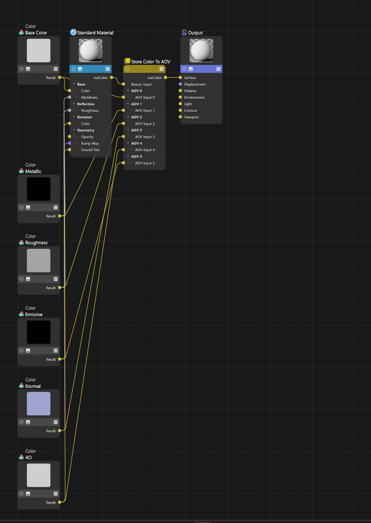

                    Resulting in this graph:
                    I hope this helps and cheers,

                        Good to hear, one thing I forgot to mention, and you might not be aware of (and are not yet reflected in the GraphDescription manual or the Nodes API examples), is that you are writing there render space values, i.e., likely ACEScg values and not sRGB values as you usually would as a user.
                        See open_color_io_2025_2.py for the technical details, but to write values as sRGB, as you probably intend to, you would have to do this:
                        import maxon
                        doc: c4d.documents.BaseDocument # The active document
                            converter: c4d.modules.render.OcioConverter = doc.GetColorConverter()
                            graph: maxon.NodesGraphModelRef = maxon.GraphDescription.GetGraph(
                                name="Simple PBR Material", nodeSpaceId=maxon.NodeSpaceIdentifiers.RedshiftMaterial)
                            # With Cinema 4D 2025.2.0 OCIO handling became mandatory. To define maxon colors/vectors
                            # in sRGB space, we have to do this. For pure white/black this is inconsequential, as there an
                            # an sRGB value is same value as in our standard render space of Cinema 4D: ACEScg. But the
                            # The sRGB color (1, 0, 0) is for example the ACEScg value (0.61, 0.07, 0.02).
                            cWhite: c4d.Vector = converter.TransformColor(
                                c4d.Vector(1), c4d.COLORSPACETRANSFORMATION_OCIO_SRGB_TO_RENDERING)
                            mWhite: maxon.Color = maxon.Color(cWhite.x, cWhite.y, cWhite.z)
                            cBlack: c4d.Vector = converter.TransformColor(
                                c4d.Vector(0), c4d.COLORSPACETRANSFORMATION_OCIO_SRGB_TO_RENDERING)
                            mBlack: maxon.Color = maxon.Color(cBlack.x, cBlack.y, cBlack.z)
                            cGray: c4d.Vector = converter.TransformColor(
                                c4d.Vector(0.5), c4d.COLORSPACETRANSFORMATION_OCIO_SRGB_TO_RENDERING)
                            mGray: maxon.Color = maxon.Color(cGray.x, cGray.y, cGray.z)
                            cPurple: c4d.Vector = converter.TransformColor(
                                c4d.Vector(0.5, 0.5, 1.0), c4d.COLORSPACETRANSFORMATION_OCIO_SRGB_TO_RENDERING)
                            mPurple: maxon.Color = maxon.Color(cPurple.x, cPurple.y, cPurple.z)
                            # Clear the graph to start fresh
                            maxon.GraphDescription.ApplyDescription(graph,
                                        "$type": "Color",
                                        "Basic/Name": "Base Color",
                                        "Inputs/Color": mWhite,
                                        "$id": "base_color"
                                        "$type": "Color",
                                        "Basic/Name": "Metallic",
                                        "Inputs/Color": mBlack,
                                        "$id": "metallic_color"
                                        "$type": "Color",
                                        "Basic/Name": "Roughness",
                                        "Inputs/Color": mGray,
                                        "$id": "roughness_color"
                                        "$type": "Color",
                                        "Basic/Name": "Normal",
                                        "Inputs/Color": mPurple,
                                        "$id": "normal_color"
                                        "$type": "Color",
                                        "Basic/Name": "AO",
                                        "$id": "ao_color"
                                        "$type": "Color",
                                        "Basic/Name": "Emissive",
                                        "$id": "emissive_color"
                                    "$type": "Output",
                                    "Surface": {
                                        "$type": "Store Color To AOV",
                                        "AOV Input 0": "#base_color",
                                        "AOV Name 0": "BaseColor",
                                        "AOV Input 1": "#metallic_color",
                                        "AOV Name 1": "Metallic",
                                        "AOV Input 2": "#roughness_color",
                                        "AOV Name 2": "Roughness",
                                        "AOV Input 3": "#normal_color",
                                        "AOV Name 3": "Normal",
                                        "AOV Input 4": "#ao_color",
                                        "AOV Name 4": "AO",
                                        "AOV Input 5": "#emissive_color",
                                        "AOV Name 5": "Emissive",
                                        "Beauty Input": {
                                            "$type": "Standard Material",
                                            "Base/Color": "#base_color",
                                            "Base/Metalness": "#metallic_color",
                                            "Reflection/Roughness": "#roughness_color",
                                            "Geometry/Bump Map": "#normal_color",
                                            "Geometry/Overall Tint": "#ao_color",
                                            "Emission/Color": "#emissive_color",

                          Thank you very much for pointing this out.
                          I knew that Cinema 4D’s UI includes a “Linear Numeric Values” button to switch between color spaces, but I wasn’t aware of how to properly handle this conversion in code until you showed me.
                          Your reference to the open_color_io_2025_2.py example is really helpful for better understanding how to manage color spaces in scripts.
                          Thanks again for the great insight!
