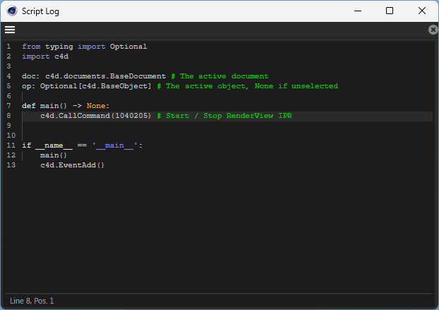

            Unfortunately, c4d.CallCommand(1040239) didn’t work on my setup (last version of C4D+Redshift)
            However, your suggestion to use the Script Log was spot on — it led me to the correct command ID for toggling the Redshift IPR:
            c4d.CallCommand(1040205)
            Appreciate the guidance!
