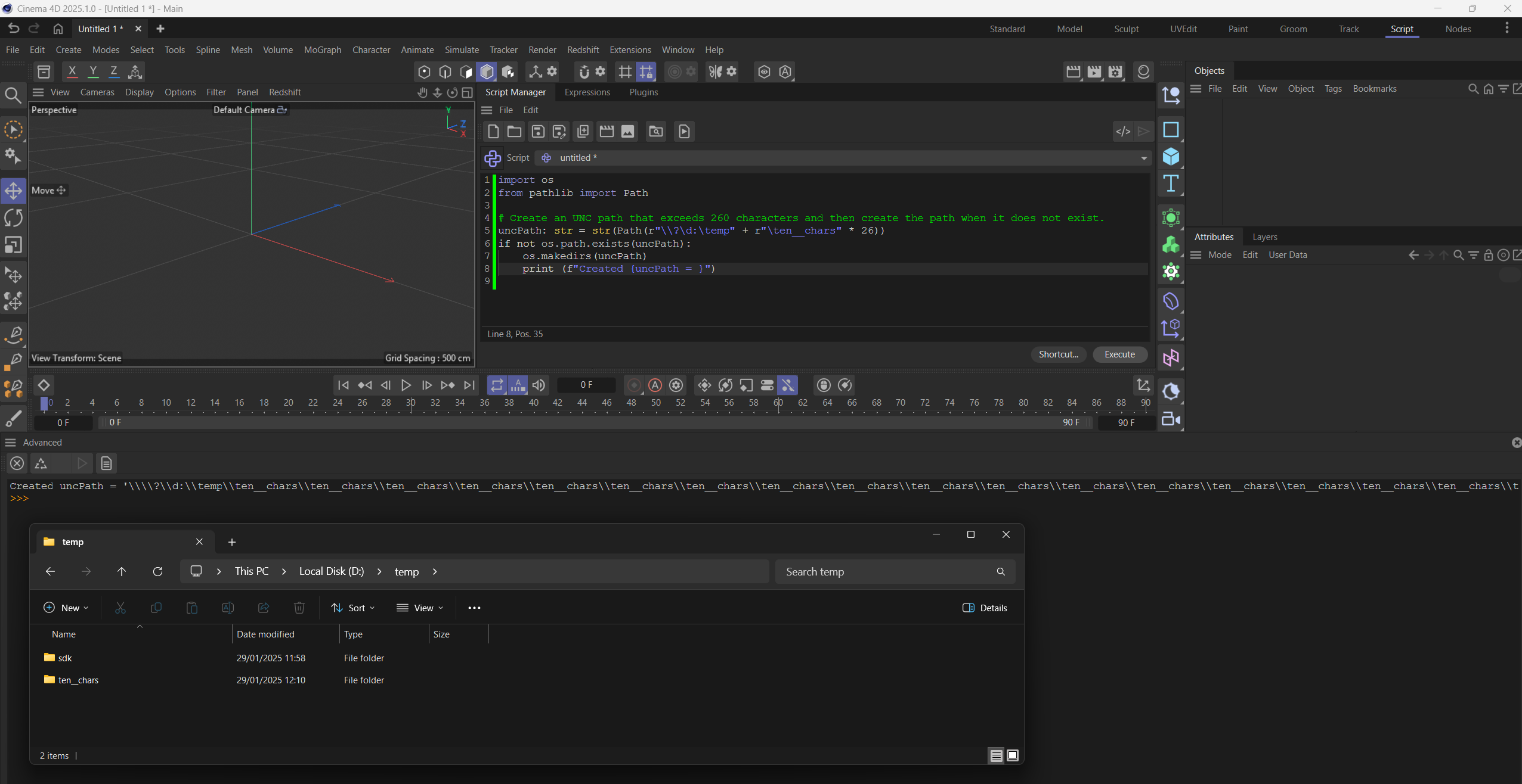

        Cinema 4D itself does not offer native Win32 overly long path support, i.e., does not set <ws2:longPathAware>true</ws2:longPathAware> in its manifest. This is a limitation induced by Redshift. The outcome is, that Cinema 4D supports overly long paths via UNC in its native settings, e.g., Render Settings/Save/File. But when you try to paste such overly long path into a Redshift RS Texture node, Cinema 4D will go up in flames.
        You can imitate that in Python, and use UNC paths for overly long paths:
        import os
        from pathlib import Path
        # Define an UNC path that exceeds 260 characters and then create it when it does not exist.
        uncPath: str = str(Path(r"\\?\d:\temp" + r"\ten__chars" * 26))
        if not os.path.exists(uncPath):
            os.makedirs(uncPath)
            print (f"Created {uncPath = }")
        We might be able to add longPathAware support for our Python VM (Cinema 4D itself cannot do it, as this would entail errors for Redshift). I do not own the relevant systems, so I cannot really judge how hard that would be to do (@m_adam does). But UNC strikes me as fine, and generally enabling longPathAware support for the Python DLL while keeping it for the app disabled also rather risky.
