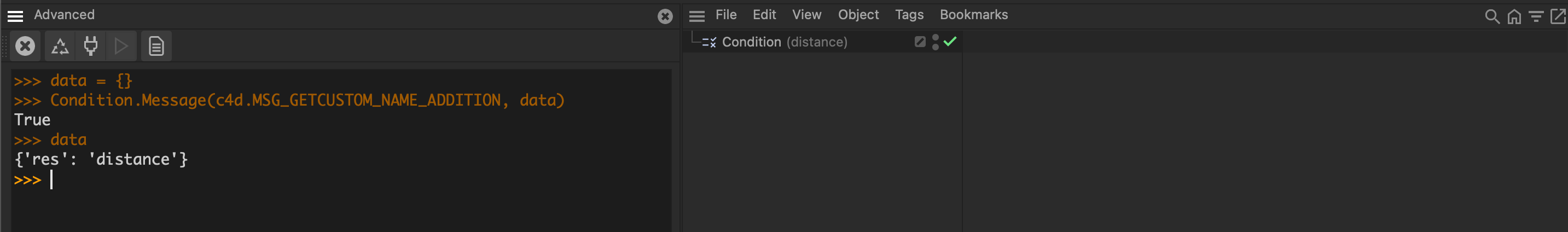

      Hello, I noticed there seemed to be a new 'name' feature with the Condition object.
      Is it possible to make use of it in a plugin?
      'Condition' is just the object's Name, but I can't figure out how 'distance' is set.

        Thank you for reaching out to us. That feature has existed since Pyro was introduced but at the same time it is also an internal feature, i.e., a feature of which we publish the components, but which we do not support in public usage. To realize a node which supports name additions, you must register it with the flag OBJECT_CUSTOM_NAME_ADDITION:
        RegisterObjectPlugin(ID_MY_PLUGIN, GeLoadString(IDS_MY_PLUGIN), otherFlags | OBJECT_CUSTOM_NAME_ADDITION, MyPlugin::Alloc, "omyplugin"_s, nullptr, 0);
        Reading or writing to the custom name is then realised via the node message MSG_GETCUSTOM_NAME_ADDITION. I am showing the write access in C++:
        Bool MyPlugin::Message(GeListNode* node, Int32 type, void* data)
          switch (type)
            // Something, for example the Object Manager, wants to know the addition to the name. The
            // message data is just an empty string. The plugin should return the addition to the name.
            case MSG_GETCUSTOM_NAME_ADDITION:
              *reinterpret_cast<String*>(data) = "Hello World"_s;
              break;
            default:
              break;
        And since nothing is safe from @m_adam 😄 , I just found out that he wrapped the reading part for Python (cannot see the writing part handled in Python). Since you cannot cast arbitrary data in Python, we must use a dictionary as the data container.
