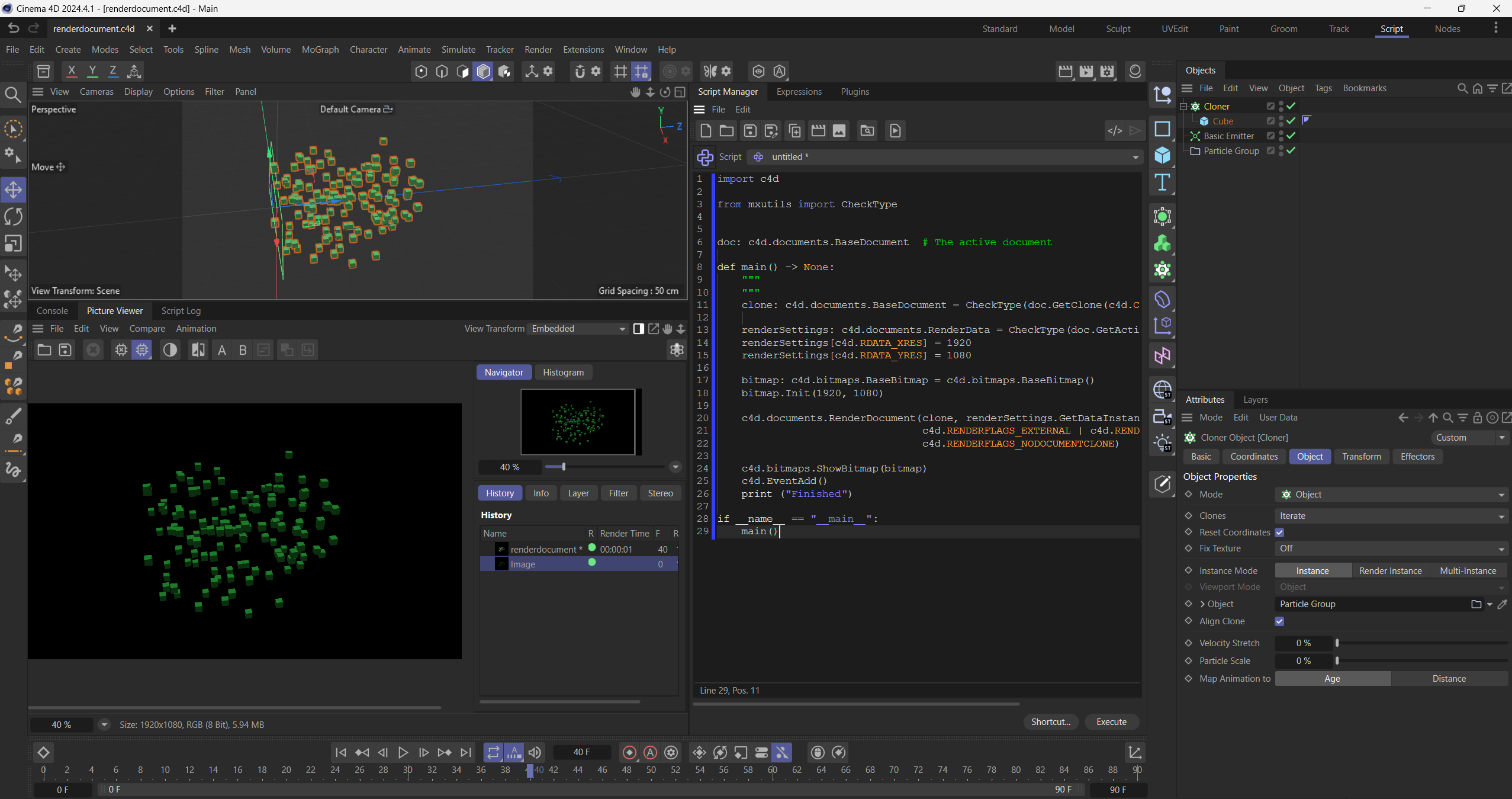

                  Hey @peter_horvath,
                  we have touched this with 2024.4.1. For me this now looks like that it is doing what it should do. Can you give it a spin and tell us if it works for you too?
                  Code
                  from mxutils import CheckType
                  doc: c4d.documents.BaseDocument  # The active document
                      clone: c4d.documents.BaseDocument = CheckType(doc.GetClone(c4d.COPYFLAGS_DOCUMENT, None))
                      renderSettings: c4d.documents.RenderData = CheckType(doc.GetActiveRenderData())
                      renderSettings[c4d.RDATA_XRES] = 1920
                      renderSettings[c4d.RDATA_YRES] = 1080
                      bitmap: c4d.bitmaps.BaseBitmap = c4d.bitmaps.BaseBitmap()
                      bitmap.Init(1920, 1080)
                      c4d.documents.RenderDocument(clone, renderSettings.GetDataInstance(), bitmap,
                                                   c4d.RENDERFLAGS_EXTERNAL | c4d.RENDERFLAGS_BATCHRENDER |
                                                   c4d.RENDERFLAGS_NODOCUMENTCLONE)
                      c4d.bitmaps.ShowBitmap(bitmap)
                      print ("Finished")
                  • P Offline
