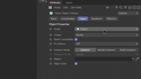

      I am trying to control which parameters of ObjectPlugin are shown/hidden depending on the values of another parameter.
      For example, the Cloner object switches which parameters it displays depending on its "mode" parameter.
      From the other threads I see that overriding GetDDescription() is the key to achieving this, but I just can't get it to work.
      Any help would be appreciated.
