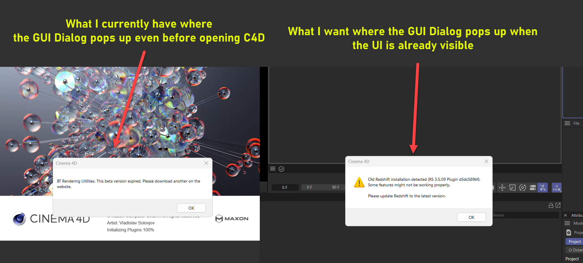

      How do I run a dialog after C4D UI launches not before?
      Here is the code that I used:
          if condition:
              c4d.gui.MessageDialog("BT Rendering Utilities. This beta version expired. Please download another on the website.")
              c4d.plugins.RegisterCommandPlugin(BASE_PLUGIN_ID, "_BT Rendering Utilities Pop Up",0, None, "_BT Rendering Utilities Pop Up", MyMenuPlugin())
      H 1 Reply Last reply Reply Quote 0

          Hi @HerrMay
          Thanks for the response.
          Unfortunately, it doesn't work in my use case since that code requires the plug-in to be initialized first.
          I want to do the check first before any plug-in initialization.
          I did try to have a pseudo plug-in. The plug-in to initialize first before others. But the PluginMessage only gets called after all the plug-in is initialized.

            • B Offline
              bentraje @ferdinand
              Ah gotcha. There is no way around it as again I don't want to initialize the plug-ins at all until the UI + check works out.
              Anyway, having the the GUI dialog before C4D launches is not bad.
              I was just wondering if I can do it after without initializing all the plugins.
