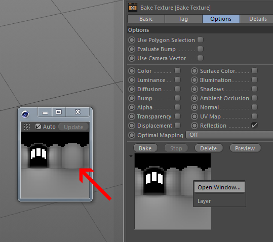

      I have some questions concerning the Bake Texture tag:
      1 - Is there command that allow to open the bake preview window
      2 - Is it possible to detect when the bake render is finished
      I imagine that there is no way to display the small image preview inside description resource via python.
      Thank you.
        1. Not really in Python, since it is inside a context menu of an gadget within a description resource.
        2. You might want to check c4d.CheckIsRunning(c4d.CHECKISRUNNING_BAKING), but I am not sure if it does work for all scenarios of baking.

                        BitmapButton.SetImage() works just fine. Here is an example on how to set a BitmapButton to a BaseBitmap that has been scaled to fit a target size.
                        from c4d import bitmaps
                        BUTTONIZE = 128
                        class TextureBakerDlg(c4d.gui.GeDialog):
                            def CreateLayout(self):
                                # Creates an image preview
                                bc = c4d.BaseContainer()
                                bc.SetBool(c4d.BITMAPBUTTON_BUTTON, False)
                                bc.SetLong(c4d.BITMAPBUTTON_BORDER, c4d.BORDER_THIN_IN)
                                self.myBitButton=self.AddCustomGui(1000, c4d.CUSTOMGUI_BITMAPBUTTON, "",
                                                                   c4d.BFH_LEFT | c4d.BFV_TOP,
                                                                   BUTTONIZE, BUTTONIZE,
                                                                   bc)
                                # Set up two bitmaps, the source bitmap (it is just the maxon logo in the top
                                # left corner of the forum) and a target sized empty bitmap
                                src_bmp = bitmaps.BaseBitmap()
                                src_bmp.InitWith(
                                    "https://developers.maxon.net/forum/assets/uploads/system/site-logo.png")
                                dst_bmp = bitmaps.BaseBitmap()
                                dst_bmp.Init(BUTTONIZE, BUTTONIZE)
                                # Scale copy our source into the target.
                                src_bmp.ScaleIt(dst_bmp, 256, True, True)
                                # Set your button.
                                self.myBitButton.SetImage(dst_bmp)
                            dlg = TextureBakerDlg()
                            dlg.Open(c4d.DLG_TYPE_ASYNC)
                        # Execute main()
                        if __name__=='__main__':
                        The fact that you do not see anything / that it 'does not work' for you is probably caused by the fact that you are passing a MultipassBitmap to your button. Check MultipassBitmap.GetLayers on how to access individual layers of BaseBitmaps in your MultipassBitmap which you could then hand to your BitmapButton.
                        zipit
                        mfersaouiM 1 Reply Last reply Reply Quote 2
                        • mfersaouiM Offline
                          mfersaoui @ferdinand
                          Thank you very much @zipit and have a good day.
