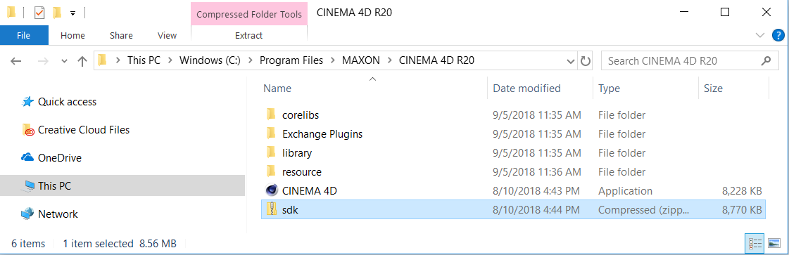

      1. Locate sdk.zip in your Cinema 4D installation directory.
        sdk.zip
        • Note: This is different from the SDK Examples GitHub Repo as it includes a critical frameworks directory.
        • If you don't have sdk.zip I think the only way to get it is to reinstall Cinema 4D.
        • I recommend keeping a backup of this .zip file somewhere.
      2. Duplicate sdk.zip into a path that is easy to access via terminal. e.g. C:\sdk.zip
        • I'm duplicating the .zip to avoid accidentally deleting it as it's hard to recover a clean version without a reinstall of C4D.
        • You may need admin rights on your machine to do this.

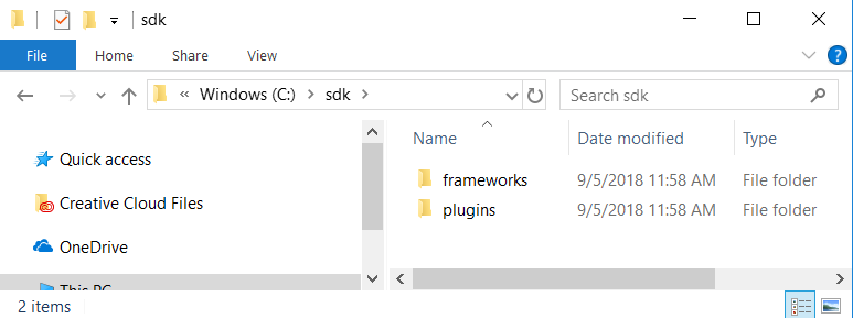

      3. Unzip the SDK to C:\sdk.

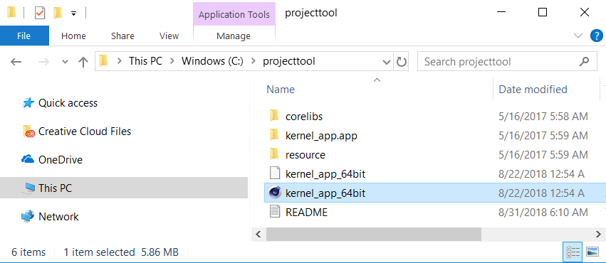

      1. Download the latest version of the C++ Project Tool[URL-REMOVED] from developers.maxon.net.
      2. Unzip the project tool to C:\projecttool, ensure that this directory contains the actual project tool and libs, not just another nested folder.
        Project Tool Directory

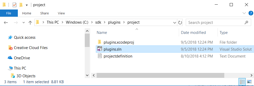

      7. In your file browser, navigate to and open C:\sdk\plugins\project\. If everything worked as expected, you should now see a file called plugins.sln
      You've now created a Visual Studio project file that could be used to compile your project. But there's still more we have to do.
