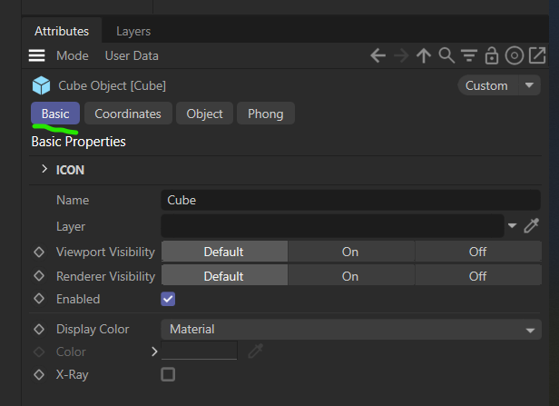

      I have NodeDatas that dont need their "Basic" to be shown. Is it possible to hide this tab?

        it depends a bit on what you do in your description, which bases you include, and what you consider NodeData instances in your case. Are you actually talking about plain NodeData hooks or are you talking about derived types such as ObjectData?
        When we look for example into Ocube.res, we can see it includes Obase:
        CONTAINER Ocube
        	NAME Ocube;
        	INCLUDE Obase;  // includes the description base for all objects Obase.res
        Which among other things contains the Obaselist group, which is the group you mean.
        You could either not include the base description for your node type, or use a modified base which for example hides all elements in that group. But I personally would say that none of these approaches are really a good idea, as Cinema 4D is designed with the assumption that each basic scene element (object, tag, etc.) includes their base description.
        Falling to do so, will either make your plugin outright not work, or - when using more 'clever' approaches such as hiding all parameters, or hiding the whole group via GetDDescription or a modified base - severely impact how users can interact with your scene element.
        When you implement a plain NodeData hook, you should not see any extra tabs, as plain node hooks should not include any bases.
