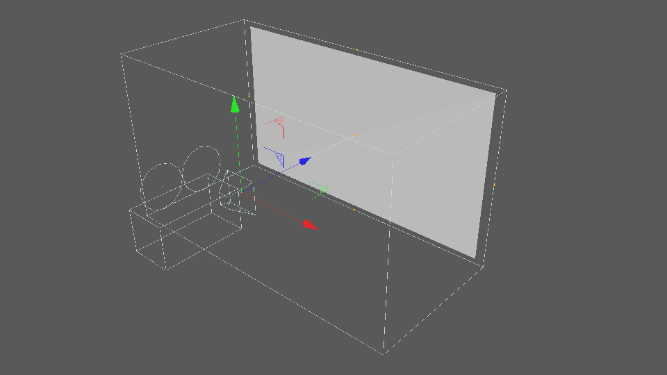

    • RE: CAMERA_ZOOM and Pparallel
      Thanks @ferdinand, this seems to have solved my problem.
      Apologies if it came across a bit abrupt, I was trying to get to the crux of it. Just seemed strange that there wasn't a way to rationally relate the zoom to any meaningful size for an orthographic camera. In other software I recall being able to set the camera as a width and height, not some factor of zoom. Made much more sense, kind of like setting it as a size. Also curious to know why they choose 1024 to underpin the zoom and not a rounded number, like 1000 (or something that can work off C4D's base unit).
      But all good here - it's working now. Solved.
      WP.

    • CAMERA_ZOOM and Pparallel
      Hi Folks,
      How does the camera zoom work with Pparallel? It feels really unituitive without knowing what the number means. How can I set the 'zoom' so that it covers a particular unit area of the viewport?
      As an example, if I have an object - say a plane that's width and height are the same in units as HD resolution (so width 1920 and height 1080), how can I set the 'zoom' so that the parallel camera covers the precise width (or height) of the plane (assume everything lines up)?
      This viewport capture might help to visualise:
      I want to know what 'zoom' means in terms of viewport unit size, so that I can set the 'zoom' to a size that reflects an object unit size in the scene.
      WP.
      posted in Cinema 4D SDK c++
