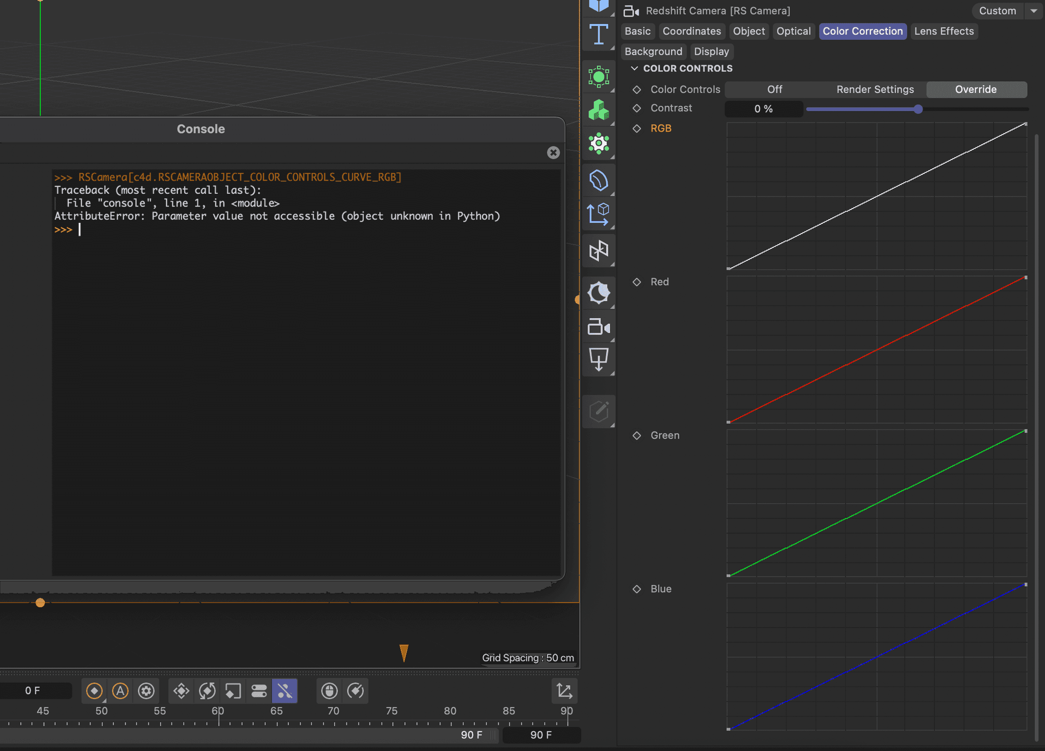

      is it possible to get access to the Color Correction curves within a Redshift Camera or within the RS Post Effects through python? Any magical ints that I'm missing? 🙂

      3c515775-7e48-4c87-bf69-2ca85aa113be-CleanShot 2026-08-31 at 22.43.25@2x.png
        ferdinand @lasselauch
        Hey @lasselauch,
        no, that is unfortunately not possible. Unlike for the other big custom data type of Redshift RSFILE, the curve data type RSPFXCURVE does not implement Get/SetParameter to access internals of the data type, as you can for the file type with REDSHIFT_FILE_PATH.
        It also stands a bit to question how such lower desc level access should work here? Maybe as a lower level which can read/write the curve as SplineData? But I am not sure if this type would be faithfully convertable to SplineData`.
        I cannot fix this as Redshift is not part of the Cinema code base where the Python API lives. I gave one of the RS developers a bump so that they maybe can implement Get/SetParameter for that custom data type.
