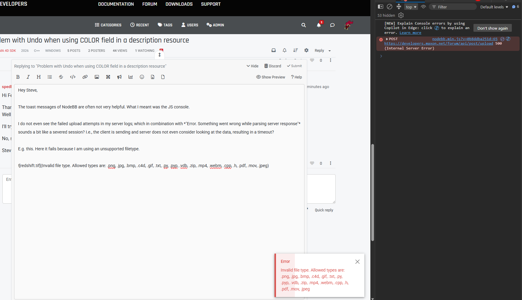

      The toast messages of NodeBB are often not very helpful. What I meant was the JS console.
      I do not even see the failed upload attempts in my server logs; which in combination with "Error. Something went wrong while parsing server response" sounds a bit like a severed session? I.e., the client is sending and server does not even consider looking at the data, resulting in a timeout?
      E.g. this. Here it fails because I am using an unsupported filetype.
      Just right click on the page, select inspect and then go to the console tab (which is usually the selected default). All modern browsers have this.
      PS: Please also expand the call stack like so:

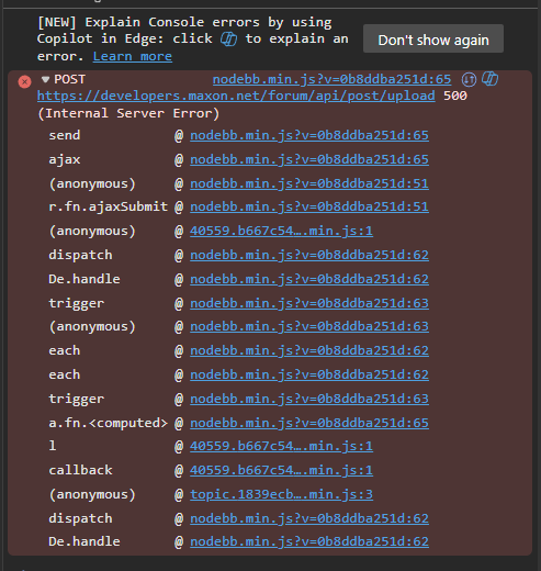

        Here is an identical situation. I can see the file upload progress reaching 100%, followed by the error message: "Error: Something went wrong while parsing server response."
        Since I am unable to successfully upload the image, below is the console information I copied.
        nodebb.min.js?v=0b8ddba251d:65  POST https://developers.maxon.net/forum/api/post/upload 403 (Forbidden)

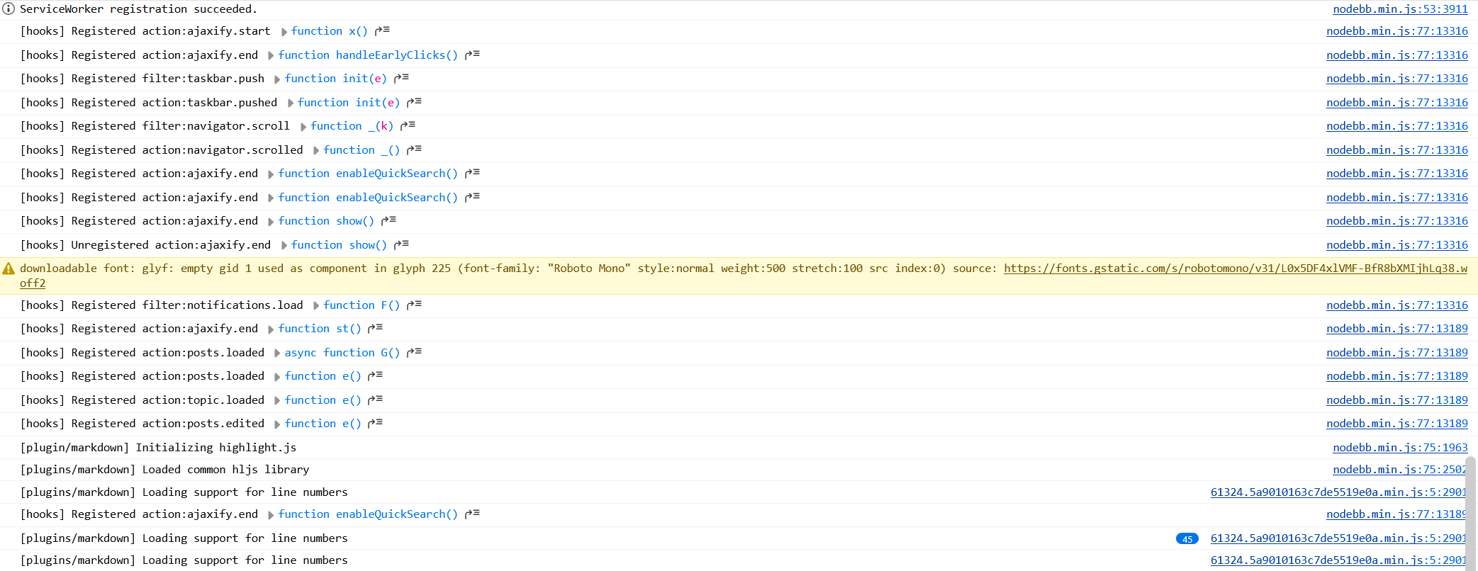

          OK, I'll try that again. Trying upload: Diamond.zip
          And the output (hope this is what you wanted!):
          alt text
          I can't even upload an image, this is a link to my site.

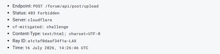

            I reproduced the upload failure and found that it is caused by a Cloudflare Challenge, rather than NodeBB itself.
            The upload request completes, but the response is:
            • Endpoint: POST /forum/api/post/upload
            • Status: 403 Forbidden
            • Server: cloudflare
            • cf-mitigated: challenge
            • Content-Type: text/html; charset=UTF-8
            • Ray ID: a1c1af0daaf34f1a-LAX
            • Time: 16 July 2026, 14:26:46 UTC
            Cloudflare returns an HTML Challenge Page to the XHR upload request. NodeBB expects a JSON upload response, so its parser subsequently reports: “Something went wrong while parsing server response.” The 100% progress only indicates that the browser finished sending the request body.
            Could you please look up this Ray ID in Cloudflare Security Events to identify which WAF/Bot Management rule issued the challenge? A narrowly scoped exception for POST /forum/api/post/upload may resolve it, since an interactive Challenge Page cannot be completed inside this AJAX upload request.
            I tested with a small PNG file in Chrome on Windows. I can provide additional non-sensitive request details if needed.
              That is the culprit. That is the data upload endpoint and something is not letting you even talk with it. Could be NodeBB misbehaving or some shenanigans by Cloudflare. I will see if I can find out more.
              edit: now I see it too, this is some cloudflare misfire
