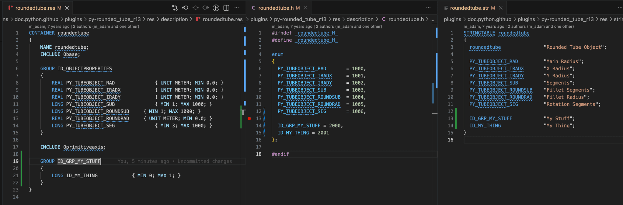

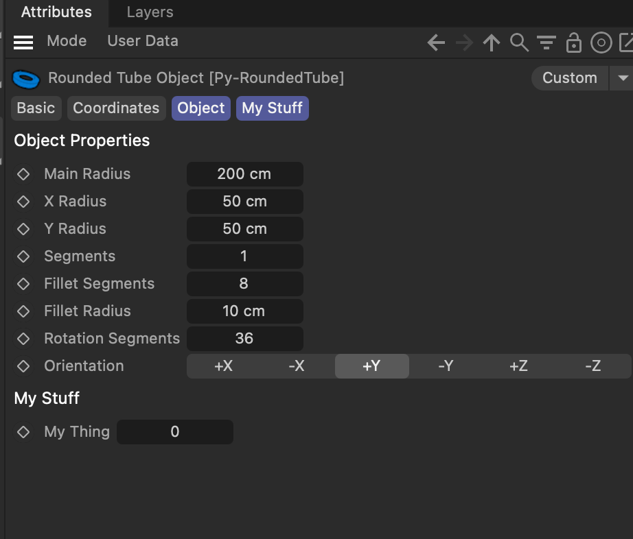

        It is pretty straight forward, you just add top level groups and they will automatically be turned into tabs. I used here the rounded tube example to add an extra tab. Make sure to reflect your group in all files (res, h, and str).
        CONTAINER roundedtube
        	NAME roundedtube;
        	INCLUDE Obase;
        	GROUP ID_OBJECTPROPERTIES
        		REAL PY_TUBEOBJECT_RAD				{ UNIT METER; MIN 0.0; }
        		REAL PY_TUBEOBJECT_IRADX			{ UNIT METER; MIN 0.0; }
        		REAL PY_TUBEOBJECT_IRADY			{ UNIT METER; MIN 0.0; }
        		LONG PY_TUBEOBJECT_SUB				{ MIN 1; MAX 1000; }
        		LONG PY_TUBEOBJECT_ROUNDSUB		{ MIN 1; MAX 1000; }
        		REAL PY_TUBEOBJECT_ROUNDRAD		{ UNIT METER; MIN 0.0; }
        		LONG PY_TUBEOBJECT_SEG				{ MIN 3; MAX 1000; }
        	INCLUDE Oprimitiveaxis;
          // The new tab group, all top level groups in a container will become tabs.
        	GROUP ID_GRP_MY_STUFF
        		LONG ID_MY_THING			{ MIN 0; MAX 1; }
        Groups are elements as any other, and when you want them to be tabs, they need an ID and should have string (see my screen).
