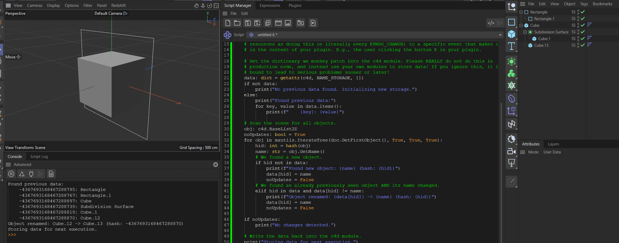

        Result
        Code
        """Demonstrates how to hash all objects in a scene to stores their names overt that hash, to then
        later detect name changes with that.
        Just create a scene, run this script, rename an object, and then run it again. This just scans for
        objects but it would be easy to extend to other scene elements.
        import mxutils
        # An attribute to inject data under into the c4d module. I am just doing this here so that a script
        # can have a persistent state and remembers what it did on the last execution. PLEASE DO NOT DO THIS
        # IN PRODUCTION CODE!
        NAME_STORAGE: str = "my_name_storage"
            # You would either bind this code to EVMSG_CHANGE messages or better (because not as wasteful)
            # to a specific event that makes sense in the context of your plugin. E.g., the user clicking the
            # button X in your plugin.
            # Get the dictionary we monkey patch into the c4d module. Please REALLY do not do this in
            # production code, and instead use your own modules to store data! If you ignore this, it is
            # bound to lead to serious problems sooner or later!
            data: dict = getattr(c4d, NAME_STORAGE, {})
            if not data:
                print("No previous data found. Initializing new storage.")
                print("Found previous data:")
                for key, value in data.items():
                    print(f"    {key}: {value}")
            # Scan the scene for all objects.
            obj: c4d.BaseList2D
            noUpdates: bool = True
            for obj in mxutils.IterateTree(doc.GetFirstObject(), True, True, True):
                # Hash the object into an integer. This is reasonably collision resistant and possible since
                # Cinema 4D 2023.2 (before there was not C4DAtom.__hash__).
                hid: int = hash(obj)
                name: str = obj.GetName()
                # We found a new object.
                if hid not in data:
                    print(f"Found new object: {name} (hash: {hid})")
                    data[hid] = name
                    noUpdates = False
                # We found an already previously seen object AND its name changed.
                elif hid in data and data[hid] != name:
                    print(f"Object renamed: {data[hid]} -> {name} (hash: {hid})")
                    data[hid] = name
                    noUpdates = False
            if noUpdates:
                print("No changes detected.")
            # Write the data back into the c4d module.
            print("Storing data for next execution.")
            setattr(c4d, NAME_STORAGE, data)
