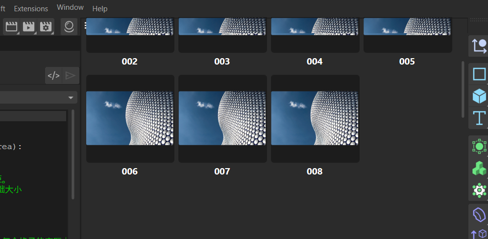

      Hi everyone,
      I'm encountering an issue when using DrawRoundedRectangle and DrawBitmapRounded in my custom GeUserArea.
      Whenever I draw elements with rounded corners, the UI content seems to overflow its intended boundary, and sometimes leaves visual artifacts (residual pixels). I've already added SetClippingRegion at the beginning of the DrawMsg
      However, it doesn't seem to help with the overflow or visual glitches when using the rounded drawing functions.
      Interestingly, when I switch back to DrawRectangle and DrawBitmap (without rounded corners), the problem goes away completely.
      Is this a known issue? Or is there any recommended way to safely use rounded drawing functions without causing overflow or artifacts?
      Thanks a lot for your help!!

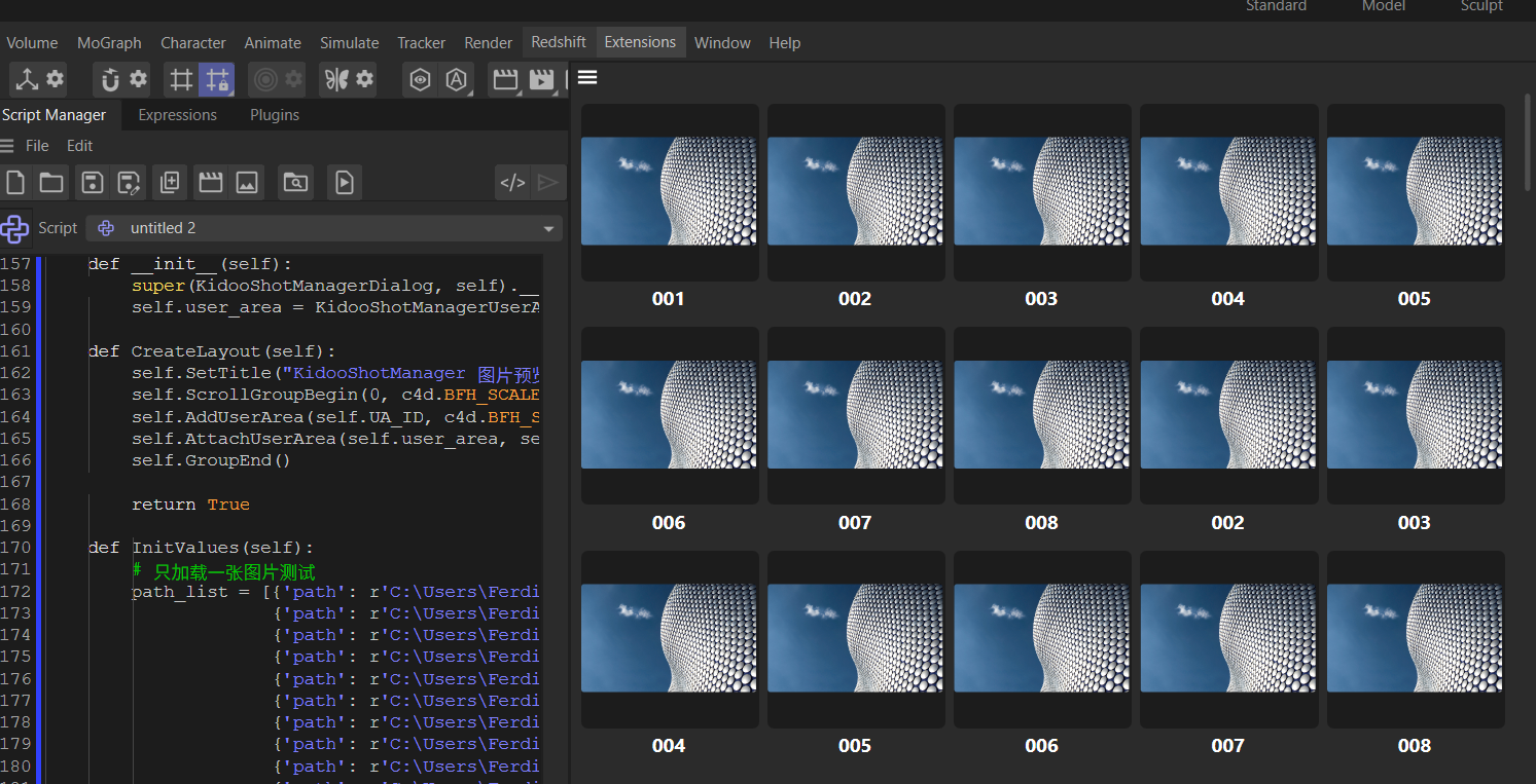

          ferdinand @Amazing_iKe
          Hey @Amazing_iKe,
          Thank you for reaching out to us.
          1. You do the same thing you did incorrectly in your other thread. You create an async dialog and you do not keep it alive.
          2. We would prefer it to keep things G-rated here. I.e., no nudity, no violence, and no weapons. I removed the image in your posting.
          With that being said, and when I try out your script (with the dlg thing fixed). I end up with this:
          I.e., it just works. But you docked your dialog (and so did I imitating what you did). I now cannot reproduce this anymore, but when I did something in my layout, I think I dragged a palette, I got a similar result as yours. That is not too surprising though as you implement here an async dialog in a hacky manner. You have no CommandData.RestoreLayout which would handle layout events for your dialog. Something getting out of whack with scroll areas is not out of question for such irregular cases.
