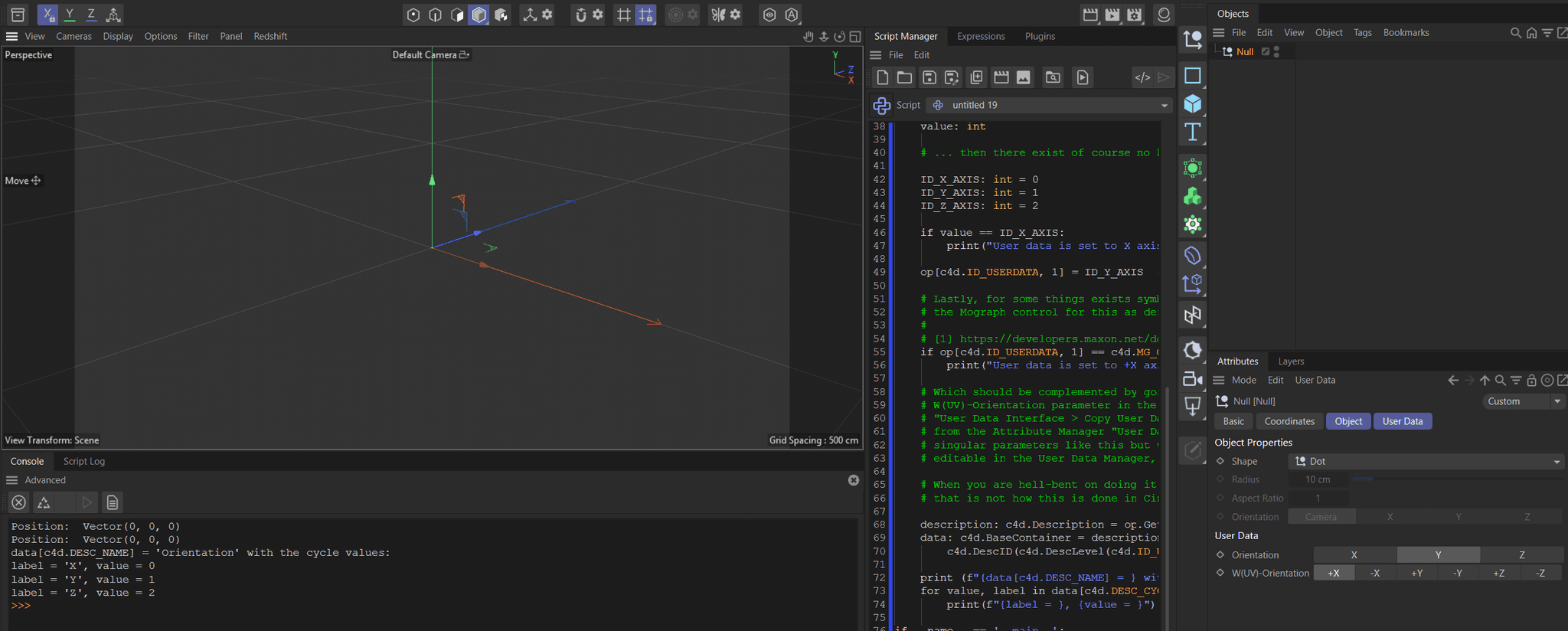

        Result
        File: param_access.c4d
        Code

            description: c4d.Description = op.GetDescription(c4d.DESCFLAGS_DESC_0)
            data: c4d.BaseContainer = description.GetParameter(
                c4d.DescID(c4d.DescLevel(c4d.ID_USERDATA), c4d.DescLevel(1)))
            print (f"{data[c4d.DESC_NAME] = } with the cycle values:")
            for value, label in data[c4d.DESC_CYCLE]:
                print(f"{label = }, {value = }")
        O 1 Reply Last reply Reply Quote 1
