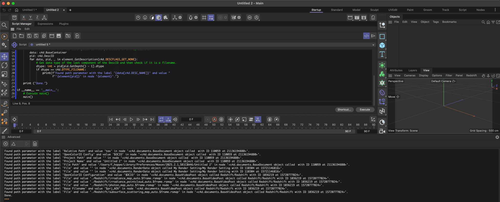

        Here for example run on an empty scene:

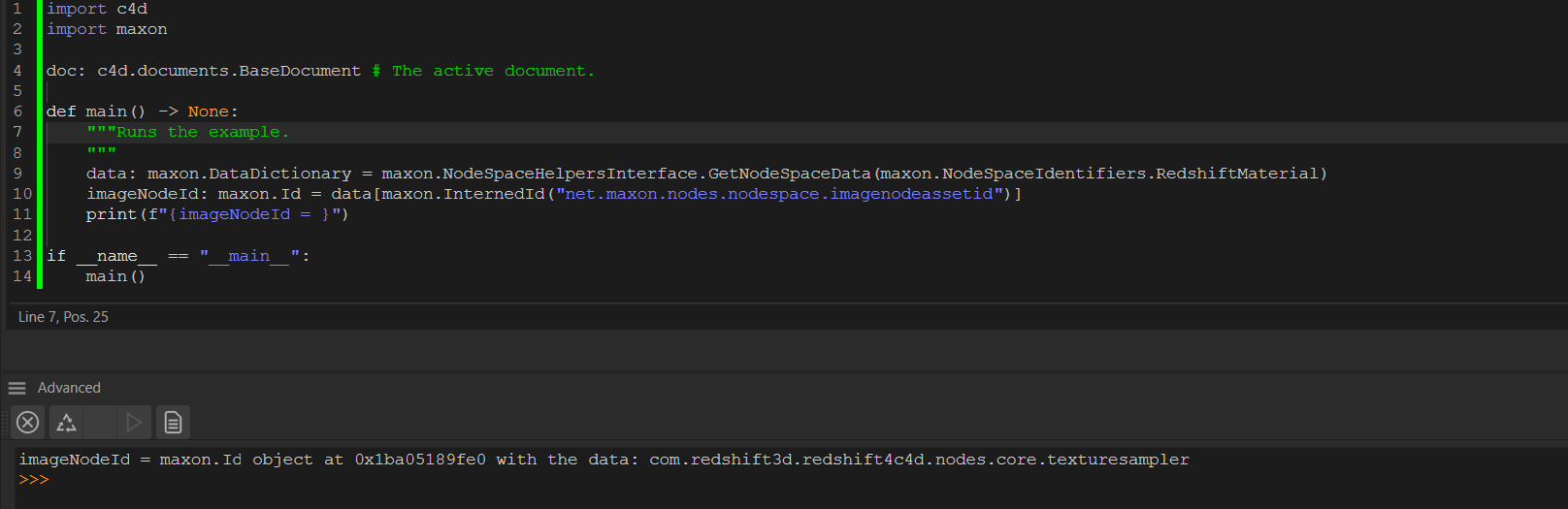

        What you will not be able to discover this way, are paths buried in GraphNode instances, e.g., nodes in Material Node graphs. You could also traverse them when you come across such graph, but that is not done automatically by RecurseGraph as it is a pure Cinema API graph traversal. Please note that when you test this locally, despite my warning, you might see your material nodes and their paths being reflected in this output. These are then Cinema API emulation (BaseList2D) nodes for the GraphNode nodes, to be able to display them in the Attribute Manager. There is no guarantee that they will be present in every scene, as they are constructed on demand, so you must traverse these graphs yourself to be sure.
        But in general, I would not advise doing this manually, as Cinema 4D scenes are much more complex than you probably realize, and you will then have to deal with all that complexity. It is not out of the question that there is a bug in MSG_GETALLASSETS as we did recently some work there, but it is more likely that you look for things being exposed by that message which simply by design are not (e.g., some cache which can be recomputed easily). What we did not even touch is the whole cloud-overly-long path thing you are doing (your last support request), and how it could interfere with asset handling.

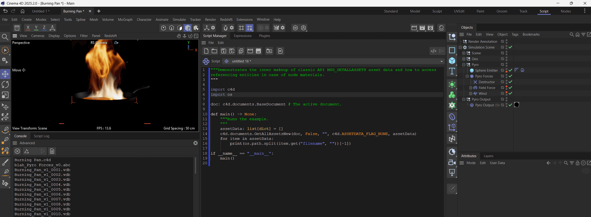

              Here's the script that we used to print all the assets in the c4d scene file based off the scripts that you shared previously.
                      import mxutils
                      for element in mxutils.RecurseGraph(doc, True, True, True):
                          # Now we iterate over its description to find parameters of DTYPE_FILENAME.
                          data: c4d.BaseContainer
                          pid: c4d.DescID
                          for data, pid, _ in element.GetDescription(c4d.DESCFLAGS_GET_NONE):
                              # Get data type of the last component of the DescID and then check if it is a filename.
                              dtype: int = pid[pid.GetDepth() - 1].dtype
                              if dtype == c4d.DTYPE_FILENAME:
                                  print(f"Found path parameter with the label '{data[c4d.DESC_NAME]}' and value "
                                      f"'{element[pid]}' in node '{element}'.")
                      asset_data: list[dict] = []
                      c4d.documents.GetAllAssetsNew(doc, False, "", c4d.ASSETDATA_FLAG_NONE, asset_data)
                      for item in asset_data:
                          print(os.path.split(item.get("filename", ""))[-1])
              And here's the output that we get while running it locally.

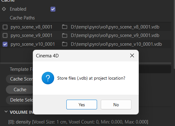

                The output you see there is part of a Python Output object cache. A VolumeLoader is the root element of all cached volumes caches¹, and then holds the individual volumes, usually data for each frame. The cache of the Output being empty means that it lacks the data to build it. Which likely means that something with your cache paths does not line up.
                ¹ - We have a bit conflicting terms here. So, there is once the notion of caches in a scene graph. That is also the kind of cache you enabled traversing when you set yieldCaches in RecurseGraph to True. Most BaseObjects have such cache, and there are two variant, but they all express the data generated by a parametric objects (a 'generator' in Cinema 4D slang). Read more about it in geometry_caches_s26.py. And then we have the Volume VDB caches on disk. For a VolumeLoader object to build its BaseObject:GetCache(), i.e., its virtual object hierarchy invisible to users, it requires access to files on disk - "the volume cache". And within this, the VolumeLoader is usually itself part of another objects cache, e.g., a Pyro Output object.

                That sounds very unlikely, as thousands of people are using Pyro. But your claim got me a bit thinking. So we have this, the 'Cache Paths' parameter of a 'Pyro Output' object which is here the likely culprit for your issues.
                and although it sort of implies that it uses relative paths when you press the 'Cache' button it very obviously does not.
                So, my suspicion would be that you simply do not have relative paths there, and when you then just move the scene (on the same machine or onto another machine, the result should be same), the 'Pyro Output' cache building fails because it requires these VDB files on disk when "Use Cache" is enabled. If you would look into your scene graph, you would probably have a null object there in the cache.
                But I still do not really understand what you are doing and why you are doing it. This strikes me a bit as one of the cases where someone asks us "What is 'a' + 1?". I can then either say "62" or say that this question does not make too much sense. And sometimes, especially more experienced developers then insist on storming that hill, although that is not really how you would tackle that problem in Cinema 4D.
                In Cinema 4D, when you want to make a scene 'moveable', you just use 'Save Project with Assets ...'. In the API this would be then c4d.documents.SaveProject. This will handle everything for you, including this Pyro case. There could be of course cases where you have some render nodes and you want to save bandwidth and storage and therefore only want to store shared asset data once. But I would really contemplate twice if storming that hill is really worth it.
                I have attached below a script which dissects a bit how to handle PYRO_OBJECT_CACHE_PATHS (there is a bit of an inconsistency how this parameter is handled in asset messages, I already talked with the simulation team about this).
                Please provide tangible data for all further questions and follow-ups.

                import maxon
                import mxutils
                op: c4d.BaseObject # The currently active object, can be None.

                def DemoAbstractTraversal() -> None:
                    """Showcases more details of how to manually traverse a scene graph.
                    # So, as quite clearly stated in the last posting, this traversal was an example. It output you
                    # all the parameters of type DTYPE_FILENAME in a scene. You can fashion this broader, but redoing
                    # all the asset finding is not trivial as everything could be custom, hence the existence of
                    # GetAllAssets().
                    # As also stated, the last example also did not traverse the Maxon API scene graph, which is
                    # where most of the modern material data is stored. The example below is a bit broader, as it
                    # also traverse DTYPE_STRING parameters with the GUI PATHS, and checks out all Maxon API
                    # node graphs. But it is still that - an example. You have to write your own code.
                    # We again iterate over everything in the Cinema API scene graph, this is very much NOT a cheap
                    # operation and should be avoided in production code when possible. In this example and my last
                    # I deliberately disable cache traversal, and I have seen that you did enable it. Do not do that,
                    # this makes it so much more expensive. Even a small scene with a few dozen objects will usually
                    # have hundreds if not thousands of scene elements when you really go everywhere. When you then
                    # traverse the description of each, you could easily end up with hundreds of thousands of
                    # operations, rendering this all very slow.
                    element: c4d.BaseList2D
                    for element in mxutils.RecurseGraph(doc, False, True, True):
                        print(f"Traversing Cinema API scene element '{element}")
                        # --- Abstract parameter processing --------------------------------------------------------
                        # Here we iterate over all parameters of the current scene element, and check if they are
                        # of type DTYPE_FILENAME or DTYPE_STRING with the GUI PATHS. So, that we also catch Pyro
                        # cache paths. But there are MANY more custom GUIs and some of them also store paths. Some
                        # of them, such as CUSTOMGUI_PATHS, are not even exposed in the public API.
                            # Step over everything that is not a parameter, of type DTYPE_FILENAME or DTYPE_STRING.
                            # For strings, only check string with the GUI 'PATHS'. This is mot even remotely every
                            # way how paths are stored in a scene. Just have a look at all CUSTOMGUI_* symbols in
                            # the C++ API, to het a sense. And these are only the exposed ones, there are more, as
                            # demonstrated by the CUSTOMGUI_PATHS symbol below.
                            if dtype not in (c4d.DTYPE_FILENAME, c4d.DTYPE_STRING) or \
                               dtype == c4d.DTYPE_STRING and data[c4d.DESC_CUSTOMGUI] != CUSTOMGUI_PATHS:
                               continue
                            # Make things a bit easier to read, since CUSTOMGUI_PATHS splits its values by newlines.
                            value: str = str(element[pid]).replace("\n", "")
                            print(f"\tFound parameter '{data[c4d.DESC_NAME]}' with value '{value}'"
                                  f"({data[c4d.DESC_CUSTOMGUI] = }, {pid[0].dtype = }).")

                def DemoAssetTraversal() -> None:
                    """Demonstrates how to handle assets in a scene.
                    # We get all assets in the scene and start iterating over them. For what you want to do, you
                    # porbably want to use the flag ASSETDATA_FLAG_MULTIPLEUSE, as will otherwise miss entities
                    # that use the same asset multiple times, e.g., two materials using the same texture.
                    container: list[dict[str, typing.Any]] = []
                    if not c4d.documents.GetAllAssetsNew(doc, False, "", c4d.ASSETDATA_FLAG_MULTIPLEUSE, container):
                        raise RuntimeError("Failed to get all assets from the document.")
                    # A little lookup table to avoid processing the same Pyro object multiple times.
                    visitedPyro: set[bytes] = set()
                    for asset in container:
                        url: str = asset.get("filename", "")
                        name: str = asset.get("assetname", "")
                        pid: int = asset.get("paramId", 0)
                        owner: c4d.BaseList2D | None = asset.get("owner", None)
                        nodePath: str = asset.get("nodePath", "")
                        nodeSpace: str = asset.get("nodeSpace", "")
                        print(f"Processing asset '{url}' with the owner '{owner.GetName() if owner else ''}' and pid '{pid}'.")
                        # Which will produce output for Pyro object like this, which is not very helpful for
                        # updating pyro caches, as it refers to internal parts of the Pyro object cache (i.e., the
                        # cache in the scene graph, not the Pyro cache on disk), that are readonly to the user.
                        # > Processing asset 'D:\temp\pyro\vol\pyro_scene_v7_0025.vdb' with the owner 'Pyro Output'
                        # > and pid '6000'.
                        # We cannot even use the parameter ID, because that ID is used in the part of the volume
                        # loader cache inside the Pyro Output cache, that is responsible for rendering frame 25 in
                        # this case.
                        # So, to fix that, we have to ignore most of the asset data, and just manually fix Pyro
                        # objects (or do more complex traversal here as shown in #AbstractTraversal()).
                        # The issue is that we get here yielded things inside a cache, (the scene graph cache
                        # that of the Pyro object), which makes very little sense at least in the public API, as
                        # these scene elements are effectively readonly to the user.
                        # We could also dos this more generically without checking the cache element being a Volume
                        # Loader, but I kept this safe.
                        if (isinstance(owner, c4d.BaseObject) and owner.GetType() == c4d.Ovolumeloader and
                            owner.GetCacheParent()):
                            while owner.GetCacheParent():
                                owner = owner.GetCacheParent()
                            if owner.GetType() == c4d.Opyro:
                                # We have already processed this Pyro object, so skip it.
                                uuid: bytes = bytes(owner.FindUniqueID(c4d.MAXON_CREATOR_ID))
                                if uuid in visitedPyro:
                                    continue
                                cachePaths: str = ProcessCachePaths(doc, owner[c4d.PYRO_OBJECT_CACHE_PATHS])
                                owner[c4d.PYRO_OBJECT_CACHE_PATHS] = cachePaths
                                cachePaths = cachePaths.replace("\n", "")
                                print(f"Updated Pyro object cache paths to '{cachePaths}'.")

                  Sorry, it took me a while to figure out a way to provide some reproducible script and data. Here are the steps that I take to reproduce the issue that I face.
                  1. I use the "Pyro Voxel" scene from the Cinema 4D asset browser.
                  2. I run the following script (the script that you shared for the Burning Pan scene)
                  import os
                  doc: c4d.documents.BaseDocument # The active document
                      print("===================")
                      #scene_file = "/insert/path/to/scene/file/pyro_voxel.c4d"
                      #doc = c4d.documents.LoadDocument(scene_file, c4d.SCENEFILTER_OBJECTS | c4d.SCENEFILTER_MATERIALS)
                      asset_list = []
                      val = c4d.documents.GetAllAssetsNew(doc, False, "", c4d.ASSETDATA_FLAG_NONE, asset_data)
                      print ("Done.")
                      print("===========")
                  1. This gives me the output

                    ferdinand @karthikbp
                    Hey @karthikbp,
                    Please read my previous posting, I very likely already explained there what your issue is and provided a solution. When you just move that file "/insert/path/to/scene/file/pyro_voxel.c4d" on disk, you will break its cache paths.
                    Otherwise, you would have to provide a file/project that you made relative and which is rendering black. But I am pretty sure that you have hardcoded paths in your PYRO_OBJECT_CACHE_PATHS parameters as explained above, which will break when you just move the scene, explaining the output. The reason your script is doing what it is doing is because that scene does not have its passes executed (among other things - caches built) when you loaded it from disk. There is also the oddity that Pyro considers frame zero not part of the animation, i.e., you must nudge Pyro to frame 1 for it to start building its caches and therefore in this case also asset messages.
                    What the simulation team did with the asset messages was not so good, as they report assets inside caches and do not report the actual parameter. But as lined out above, I already told them that.
                    As mentioned before, you should also use ASSETDATA_FLAG_MULTIPLEUSE and your node material handling is completely wrong (at least form what I saw on GitHub). Both can lead to incorrect renderings.
                    PS: I have resent your validation mail to the e-mail handle your account is bound to.
                    When you write your script like this, it will also print the assets when you load the file from disk. But that is all more a technicality. Please read and follow what I wrote in my last post. This will only work when you do not move scene_file, as by default it will use absolute paths for the VDB files.
                    import os
                        scene_file = r"D:\temp\pyro\pyro_scene.c4d"
                        doc.SetTime(c4d.BaseTime(1, 30)) # Frame 1 for a 30 FPS document.
                        # Build the animations, chaches, and expressions for that 1st frame. Please see threads about prerolling for how
                        # to preroll properly, the simple approach I use here, will not work for all complex simulation prerolling tasks.
                        doc.ExecutePasses(None, True, True, True, c4d.BUILDFLAGS_NONE)
                        asset_list = []
                        print ("Done.")
                      Yup. I think I forgot to mention this in my previous post but I've been using relative paths while submitting. To get relative paths, we have been using "Window" > "Project Asset Inspector" and then clicking on all the assets and "Localize Filenames". Also we have been saving the scenes with "Save Project with Assets"

                        Why I did this is due to the oddity of how Pyro builds its caches. You wanted to see there the assets reported, which will only work when the Pyro Output node has built its cache due to how irregular MSG_GETALLASSETS has been implemented for Pyro. This is tied to the fact that Pyro will not generate output for the first frame of its simulation (loosely speaking frame zero), so I advance the scene state to frame 1 and then execute the passes so that this document has its scene state built for that first frame.
                        I am on another machine today, and I think I already deleted my Pyro temp folder on my other machine, but I am pretty sure when you remove that line, the script will still print nothing despite building the caches, because on frame zero the Pyro sim will not build anything. For rendering things, you should not need any of this.
