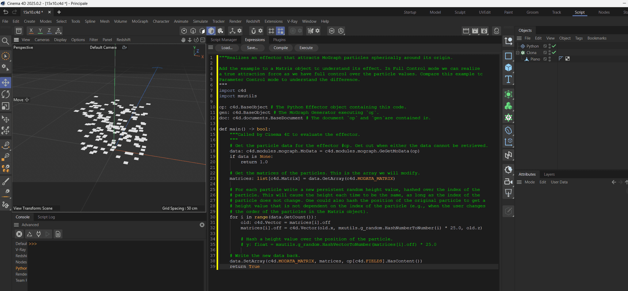

        • F Offline
          Fabio B @ferdinand
          @ferdinand Thanks, Ferdinando. The code was written by the AI. Basically, I wanted a certain number of 2cm x 2cm planes to move randomly along the Y axis. My original grid contains 62,000 of them, but for convenience, the one I posted contains 150. Since my view is oriented in a certain way, as the clones move, they'll disappear from the scene, creating a sort of shimmering or swarming fade-out effect.
            ferdinand @Fabio B
            Hey @Fabio-B,
            ⚠ Please note that we cannot provide support for AI generated code. See Support Procedures: Scope of Support for details.
            When you want the clones to move, or in other words to be animated over time, you will need a noise and cannot use hashes or random values, as they are not interpolated, i.e., continous.
            """Realizes an effector that attracts MoGraph particles spherically around its origin.
            Add the example to a Matrix object to understand its effect. In Full Control mode we can realize
            a true attraction force as we have full control over the particle values. Compare this example to
            Parameter Control mode to understand the difference.
            import mxutils
            op: c4d.BaseObject # The Python Effector object containing this code.
            gen: c4d.BaseObject # The MoGraph Generator executing `op`.
            doc: c4d.documents.BaseDocument # The document `op` and `gen`are contained in.
            def main() -> bool:
                """Called by Cinema 4D to evaluate the effector.
                # Get the particle data for the effector #op. Get out when either the data cannot be retrieved.
                data: c4d.modules.mograph.MoData = c4d.modules.mograph.GeGetMoData(op)
                if data is None:
                    return 1.0
                # Get the matrices of the particles. This is the array we will modify.
                matrices: list[c4d.Matrix] = data.GetArray(c4d.MODATA_MATRIX)
                # For each particle write a new persistent random height value, hashed over the index of the
                # particle. This will cause the height each time to be the same, as long as the index of the
                # particle does not change. One could also hash the position of the original particle to get a
                # height value that is not dependent on the index of the particle (e.g., when the user changes
                # the order of the particles in the Matrix object).
                for i in range(data.GetCount()):
                    pos: c4d.Vector = matrices[i].off
                    y: float = c4d.utils.noise.Noise(matrices[i].off, doc.GetTime().Get()) * 25.0
                    matrices[i].off = c4d.Vector(pos.x, y, pos.z)
                    # Hash a height value over the position of the particle.
                    # y: float = mxutils.g_random.HashVectorToNumber(matrices[i].off) * 25.0
                # Write the new data back.
                data.SetArray(c4d.MODATA_MATRIX, matrices, op[c4d.FIELDS].HasContent())
