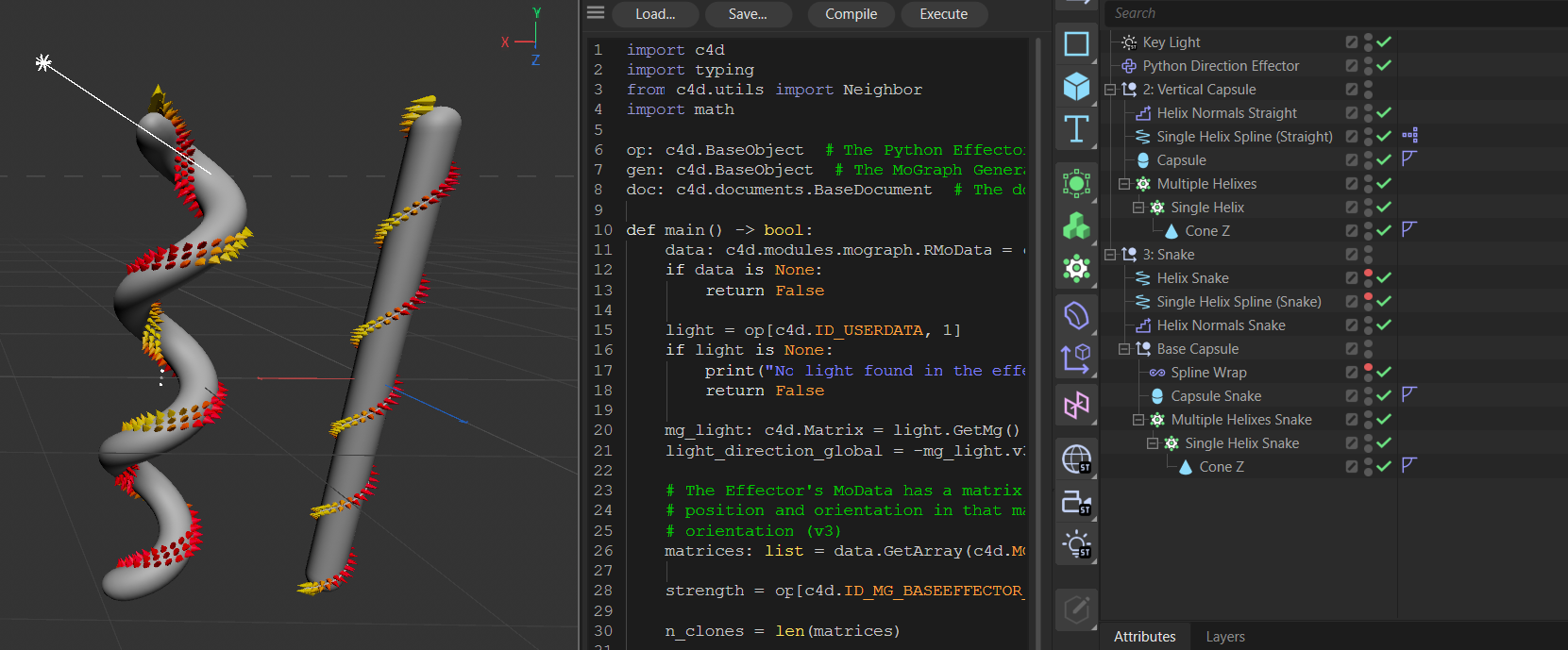

      The attached test file stems from my efforts to have clones along a cylinder that have a nice helix distribution. To achieve that, I have a first set up (under 'vertical capsule':
      • A first single helix cloner. This clones simple small spheres. To have the normal I need on these, the cloner has a step effect which rotates the clones so that the normal is perpendicular to the helix center axis.
      • A second cloner, which simply replicates the single helix cloner vertically, so that I have the density I am looking for.
      So far so good. If I apply my effector to that set up as is, I get the expected result. In the attached image, you can see that under 'vertical capsule', I have the right lighting for my spheres, congruent with my normals.
      Now, I want to deform my top cloner with a Spline Wrap. To do that, I insert the deformer as a sibling of my "multiple helixes' cloner. To make sure that I can visualize my normals on the clones, I have a little blue arrow in my cloner which is aligned along the z-axis. What I see:
      • Correct normals in both deformed and non deformed situations.
      • Correct lighting from the effector in non deformed situations. I conclude my effector is using the right clone matrices.
      • Incorrect light from the effector in deformed situation. I conclude my effector is not using the right clone matrices.
      • Display issue in the viewport.
      I have attached the test file as well as screen captures which illustrate my issue.

      Image 1 Note: the image below illustrates that the normals are correct in the cloners (even deformed). However, the Effector does not produce the right result (under 'snake issue').
      Image 2 Note: under 'snake issue', the viewport rendering does not structurally match the image viewer rendering.

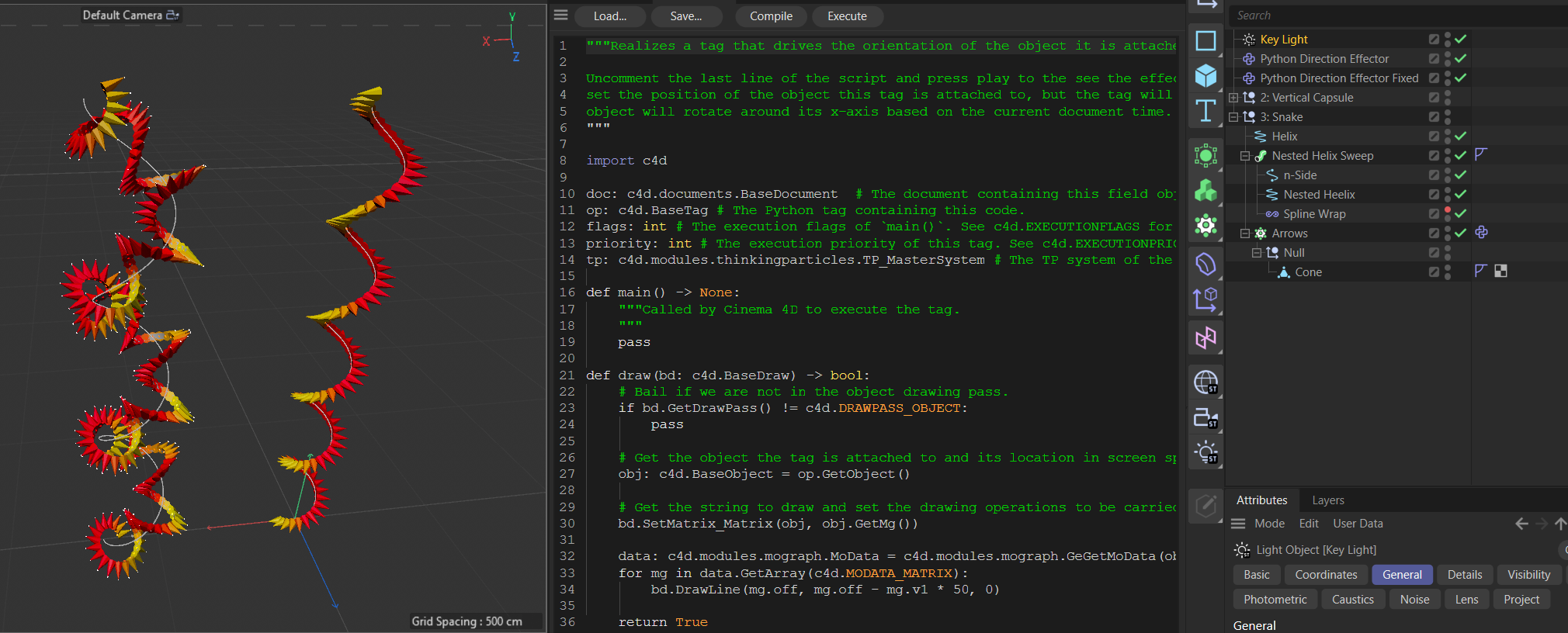

        The first thing I did, was throw out all the fluff in your file, ending up with this (one could simplify this further but I did not), I also removed the particle matrix transform in your effector code.

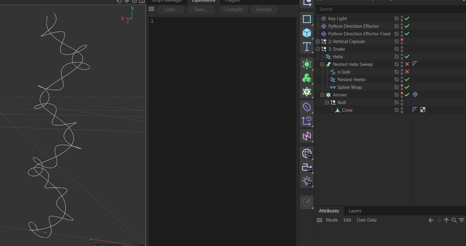

        With that it became pretty quickly apparent, that your rig cannot really work, as the left rig is basically the same as the right, only that a spline wrap deformer is applied as the last element. And particles and your Python effector can obviously not react to being deformed after they did their work.
        Furthermore, the apparent alignment of the clones on the right with their spline is only a hack, it is achieved by the mysterious step effector which just hardcodes a rotation transform which matches with rotation of the helix spline. This will obviously not work in any other cases than when the clones are arranged such linear cloning/rotation axis.
        How to Fix
        Okay, we figured out what is going wrong here, let's fix that. The first thing we must do, is create the 'snake' (as you named it), i.e., the nested inner helix winding around an outer helix as a singular geometry. I did it like this, I just wrap one helix around the other:
        Another issue with your rig is that you try to clone onto splines. Which in itself is fine, but you also want to align the clones along the spline. Along what you probably consider the "normals" of the spline. The normals of a spline are not what most artists think they are, we once talked about it here. The MoGraph cloner also uses parallel transport when "Align Clones" is checked, but with a sweep object we have more control and its parallel transport is also just better. So I created a sweep object onto which we will clone.
        Now we are pretty much done, I wasted a few minutes with pondering why my colors were not what I thought they should be and then wrote me this little Python tag with its draw function, to see where the clone normals point, to find out that the alignment option seems to swizzle axis, and we having to pick the i/v1/x axis in this case and not k/v3/z as one would expect.
        When we now put everything together, we end up with this, the colors on "my" rig are inverted compared to yours, as I did not bother fixing your "correct" case.
        What I did not fix either, is your math. You do not take the position of the light source into account, which does not make that much sense to me for a directed not-infinitely-distant light source as you use there, but maybe I am misunderstanding your goals.
        The updated file: normal-effector-deformer-debug-v3.c4d

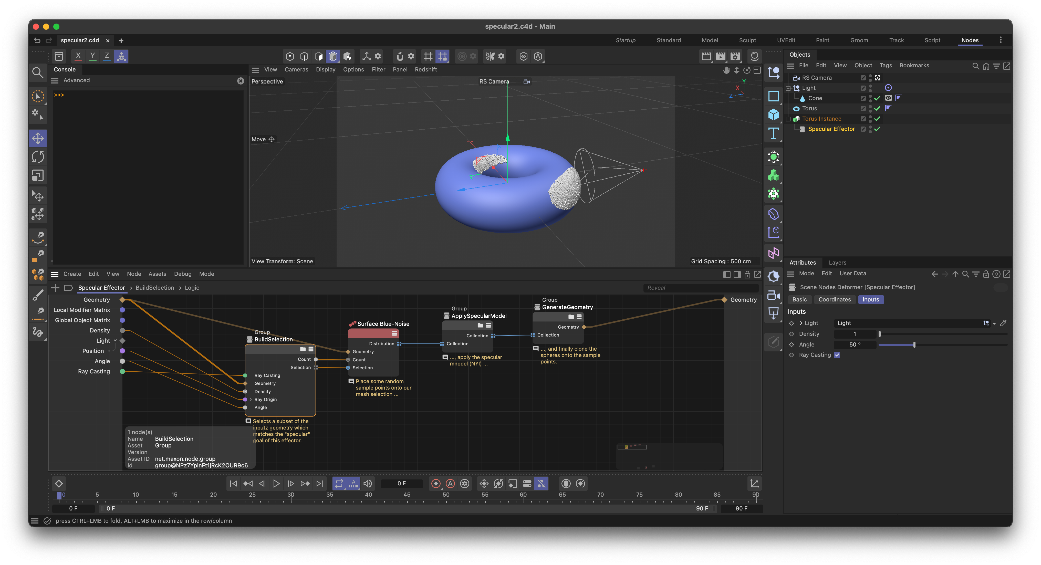

        I once crated this scene nodes effector which might be close to what you want to do, and might give you some ideas (I used there ray casting to get the self-shadowing effect):

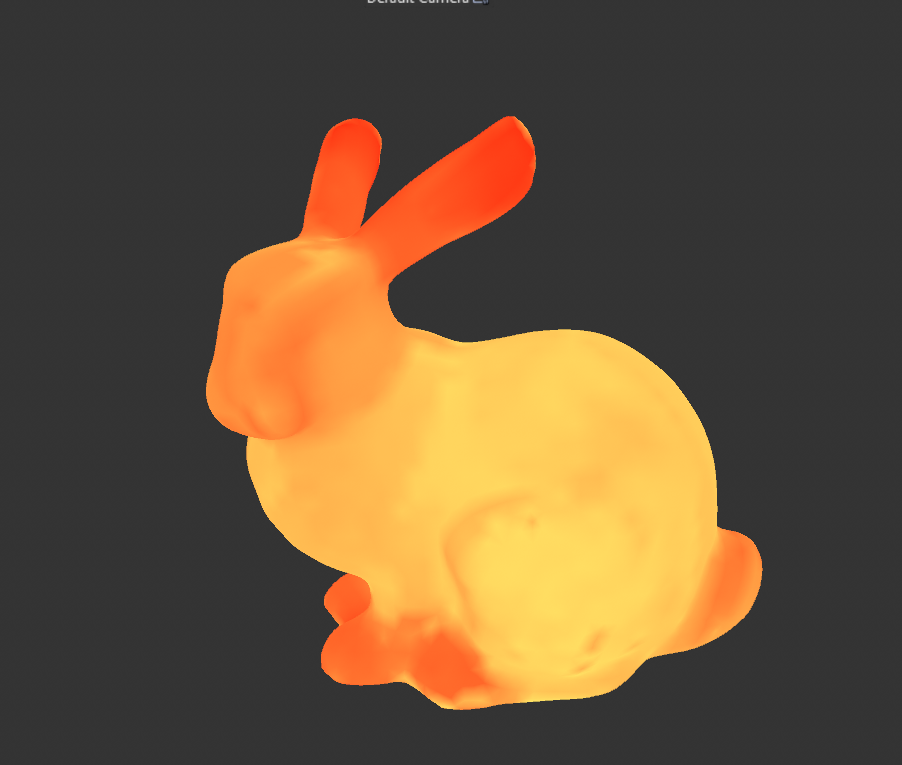

          My question was whether or not I was doing something incorrect in my effector code, and after reading your message, I understand that what I did not account for was the processing order of the generators, effectors and deformers. The effector being called before deformers apply, I could not expect to get the result I wanted. Thanks for making that clear to me.
          I worked on the example you sent because I wanted to make sure my effector worked generally, i.e., with any geometry that has its normal along the positive z axis, and avoid having to special-case my effector to a particular cloner it applies to. I illustrated this in normal-effector-axis-test-v1.c4d:
          The effector you sent and the original one are applied to simple geometry. On the left is the original effector (working with z-axis), on the right in the effector in the example you sent which compensated for a rotation in the cloner (which uses the negative x-axis).
          I modified the example so I can use the original effector working with the regular surface normal (on Z) with the technique your sent for generating geometry that let's me control the normals as I need them. This is the attached normal-effector-axis-test-v2.c4d
          On the left is the geometry you sent with my effector, just modifying the cloner to not apply a 90 degree rotation on H. The colors are the opposite because I have yellow for light and red for dark and yours has the opposite as you explained in your message.
