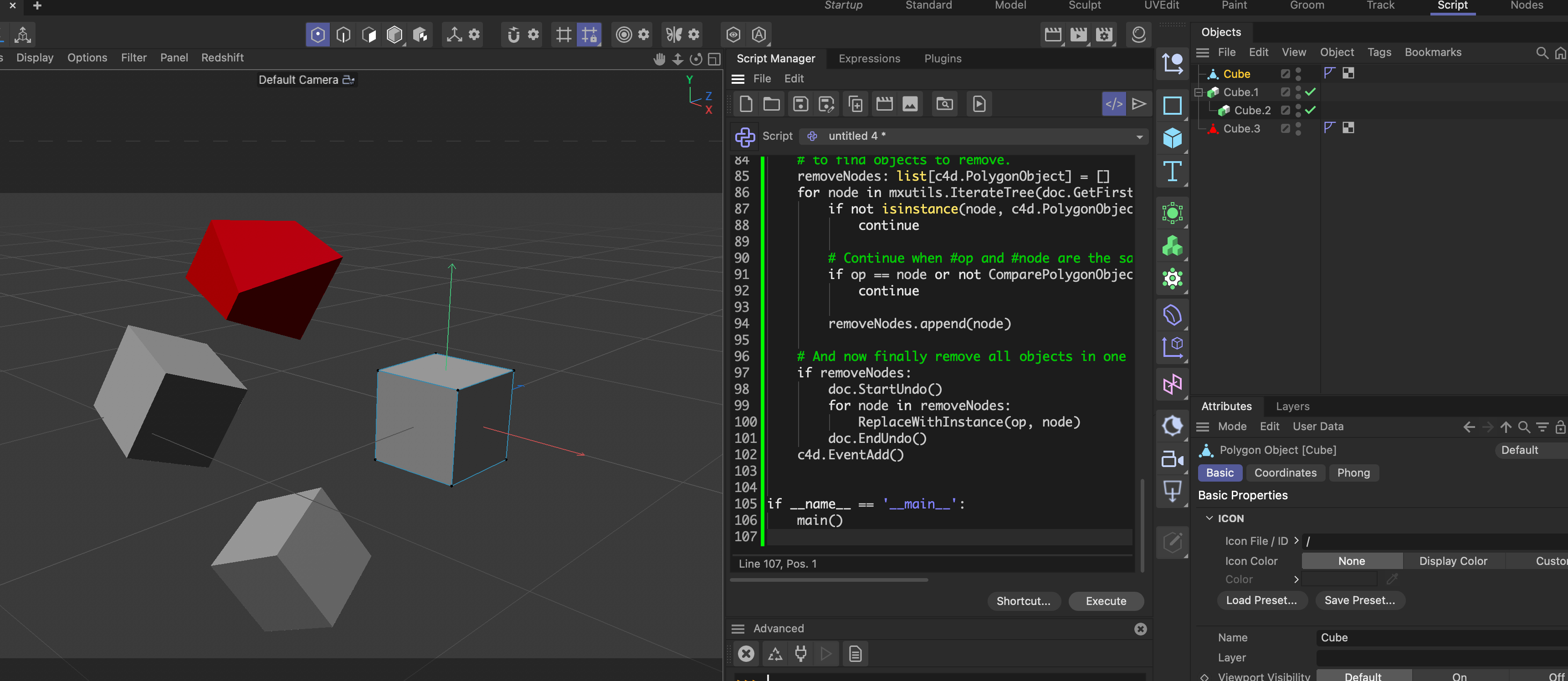

        But, yes, that is possible. You must just iterate over the object tree and then replace things. The tricky thing is to figure out when two nodes (objects) are the same. Just using the point count would be of course an incredibly poor measure of equality. But even when you properly compare the geometry, you could have two objects with identical geometry but different parameters (e.g., one is in layer A and one in layer B) or different nodes attached to them (e.g., one has material tag, and one does not). This can all be dealt with but requires some work and knowledge of our API. What then often also happens is that you want changes for equability except for X and Y which you want to ignore (which then interferes with you just plainly comparing the data containers of nodes for example).
        So, long story short, there might be more technical hurdles than you think, but that is all possible. But we cannot write a finished solution for you. We in fact expect users to post code and a concrete API question before we answer. Below you can find a sketch for how you could do this (only works in Cinema 4D 2025.0.0+ because I used mxutils.IterateTree.
        Result
        Before

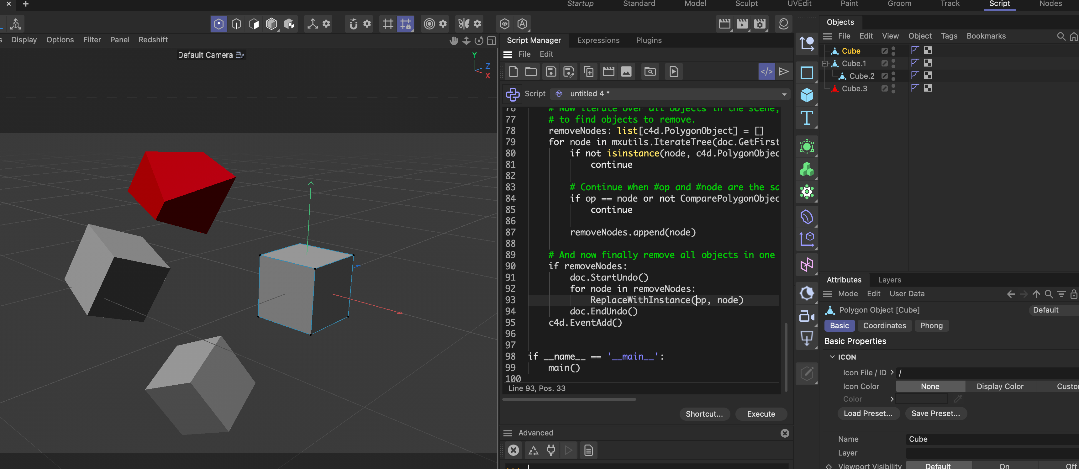

        After (Cube.1 and .2 have been replaced with instances, but .3 not because it has different point values).
        Code
        """Replaces all polygon objects that have the same topology as the selected object with instance
        objects.
        This will only operate on editable polygon objects. This script requires Cinema 4D 2025.0.0 or higher.
        It could be translated to older versions, mxutils.IterateTree would then have to be replaced.
        import mxutils
        def ComparePolygonObjects(a: c4d.PolygonObject, b: c4d.PolygonObject) -> bool:
            """Compares two polygon objects for equality, evaluated over their points and topology.
            # When the point values aren't the same, both objects cannot be the same.
            if a.GetAllPoints() != b.GetAllPoints():
                return False
            # For the topology we unfortunately must be a bit more manual.
            topologyA: list[c4d.CPolygon] = a.GetAllPolygons()
            topologyB: list[c4d.CPolygon] = b.GetAllPolygons()
            if len(topologyA) != len(topologyB):
                return False
            # We iterate over all polygons in #a and #b in pairs (x, y) and compare each vertex of the polygon
            # for referencing the same point. Internally, Cinema 4D stores everything as quads, hence us
            # blindly checking a, b, c, and d.
            for x, y in zip(topologyA, topologyB):
                if (x.a != y.a or x.b != y.b or x.c != y.c or x.d != y.d):
                    return False
        def ReplaceWithInstance(source: c4d.PolygonObject, target: c4d.PolygonObject) -> None:
            """Replaces #target with an instance object of #source, while copying over the transform and
            name of #target.
            doc: c4d.documents.BaseDocument = source.GetDocument()
            # Create an instance object and copy over the necessary data.
            instance: c4d.BaseObject = mxutils.CheckType(c4d.BaseObject(c4d.Oinstance))
            instance[c4d.INSTANCEOBJECT_LINK] = source # Link the source object.
            instance.SetName(target.GetName()) # Copy the name.
            if target.GetNBit(c4d.NBIT_OM1_FOLD): # Unfold the instance when the target was unfolded.
                instance.ChangeNBit(c4d.NBIT_OM1_FOLD, c4d.NBITCONTROL_SET)
            ml: c4d.Matrix = target.GetMl() # A copy of the PSR of #target in relation to its parent.
            # Get an insertion point, remove the target, and insert the instance. Also move all the children
            # from #target to #instance
            previous: c4d.BaseObject = target.GetPred()
            parent: c4d.BaseObject = target.GetUp()
            doc.AddUndo(c4d.UNDOTYPE_DELETE, target)
            target.Remove()
            doc.InsertObject(instance, parent, previous)
            doc.AddUndo(c4d.UNDOTYPE_NEWOBJ, instance)
            doc.AddUndo(c4d.UNDOTYPE_CHANGE, instance)
            instance.SetMl(ml) # Write the local transform back to the instance.
            for child in target.GetChildren():
                doc.AddUndo(c4d.UNDOTYPE_CHANGE, child)
                child.Remove()
                child.InsertUnderLast(instance)
            # Get out when the selected object is not a polygon object.
            if not isinstance(op, c4d.PolygonObject):
                raise TypeError("You must selected an editable PolygonObject to replace.")
            # Get the points and polygons of the currently selected object.
            basePoints: list[c4d.Vector] = op.GetAllPoints()
            basePolygons: list[c4d.CPolygon] = op.GetAllPolygons()
            # Now iterate over all objects in the scene, stepping over all non-polygon objects and ourselves,
            # to find objects to remove.
            removeNodes: list[c4d.PolygonObject] = []
            for node in mxutils.IterateTree(doc.GetFirstObject(), True):
                if not isinstance(node, c4d.PolygonObject):
                    continue
                # Continue when #op and #node are the same entity or when they are not equal.
                if op == node or not ComparePolygonObjects(op, node):
                    continue
                removeNodes.append(node)
            # And now finally remove all objects in one undo.
            if removeNodes:
                doc.StartUndo()
                for node in removeNodes:
                    ReplaceWithInstance(op, node)
                doc.EndUndo()
