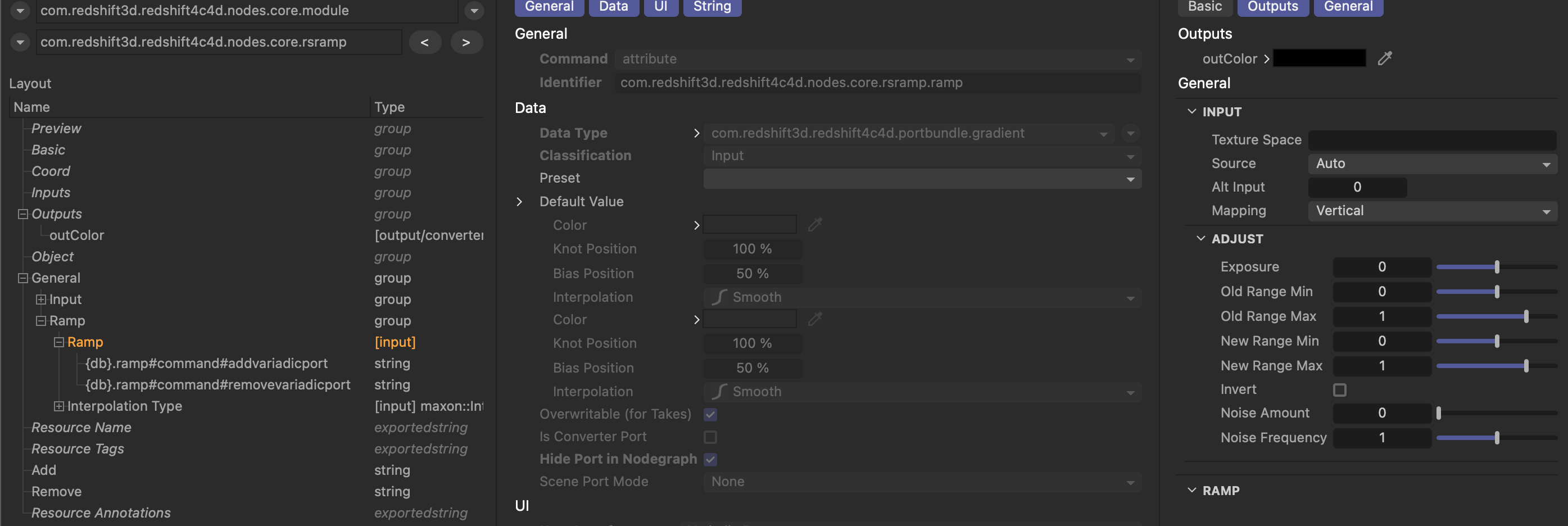

      I want to get the value of the knots' color,interpolation,knot position and bias position of a rsramp node .It seems that it is a special data type that I can not get it like "GetOrDefaultmaxon::Float64()".

        You get these parameters just as any others. Please show us the code you have, as I am not going to write here a complex node example from scratch. The ramp itself is just a variadic port, and each knot in the ramp is then a port bundle of type com.redshift3d.redshift4c4d.portbundle.gradient.
        So, the node path for the input port of the knot position of the 0ths node would be:
        // This node path goes from the root of the true node, i.e., the RS Ramp node itself.
        const String path = "<com.redshift3d.redshift4c4d.nodes.core.rsramp.ramp/_0/position"_s;
        Please note that there is absolutely no guarantee that each variadic port does gives its 0th child the ID "_0" and its n-th child the ID "_n-1". I just happen to know that this will be the case for a default RS Ramp node. In practice you will always have to get all children of the varidiadic port, and then select the desired child by index in that list.

          Thank you for the answer! The problem is solved after I try to find the child of the port according to your answer.
