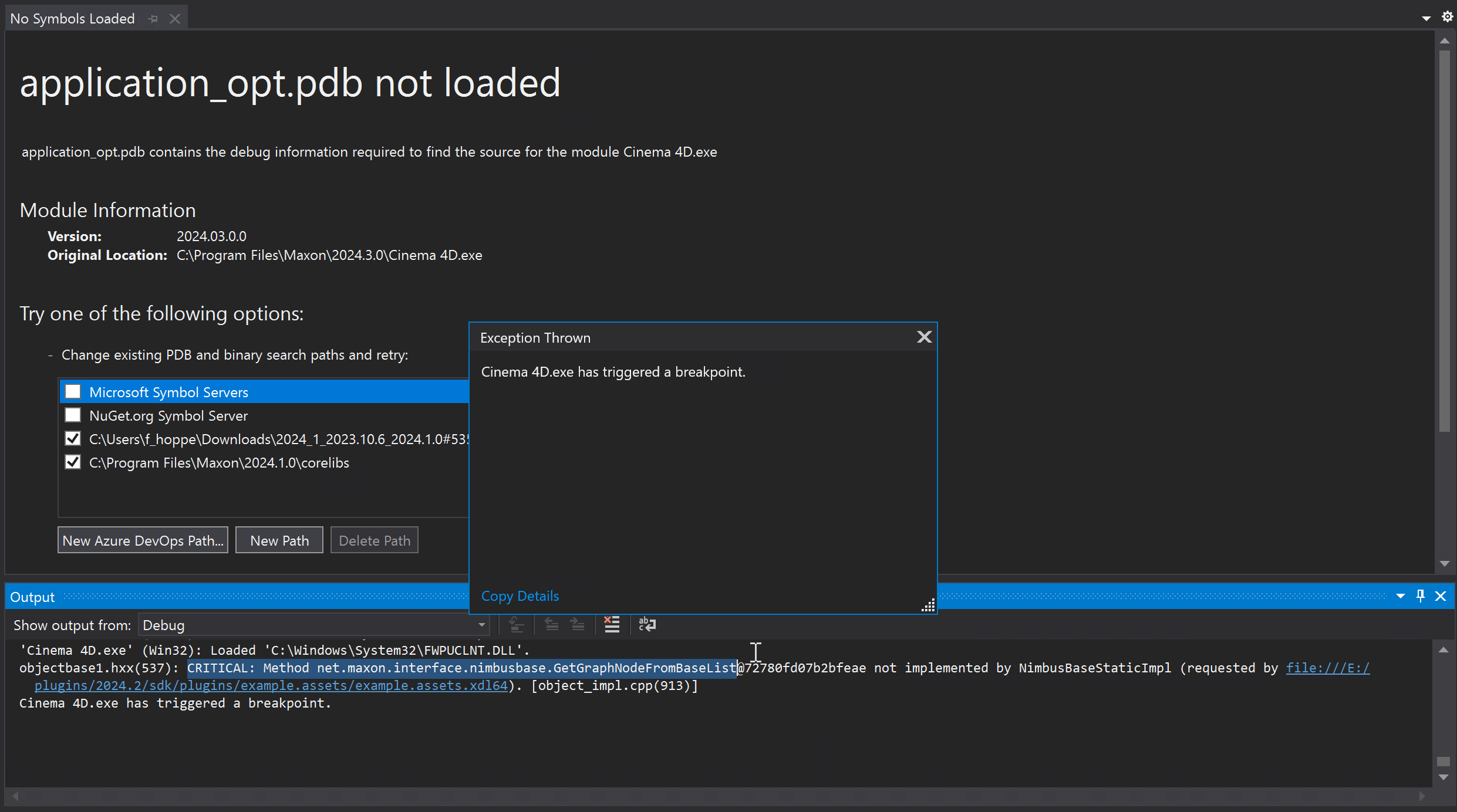

      All 2024.0.X to 2024.2.X plugins using the affected entities are not upwards compatible beyond 2024.2.X. Since the C++ SDK is using the type NimbusBaseInterface too, it will raise a critical stop when debugging with a 2024.0 up to 2024.2 SDK against a 2024.3 Cinema 4D binary. Below you can see an example of the critical stop being raised.

      • Do not debug against 2024.3.X
      • Remove the line plugins/example.assets;\ from \sdk\plugins\project\projectdefintion.txt and rebuild your solution using the project tool.
      • You can also simply ignore the critical stop and press continue once when you boot. Since you are not shipping the example.asset.xdl64/dylib binaries with your plugin, it will not be affected by this.
