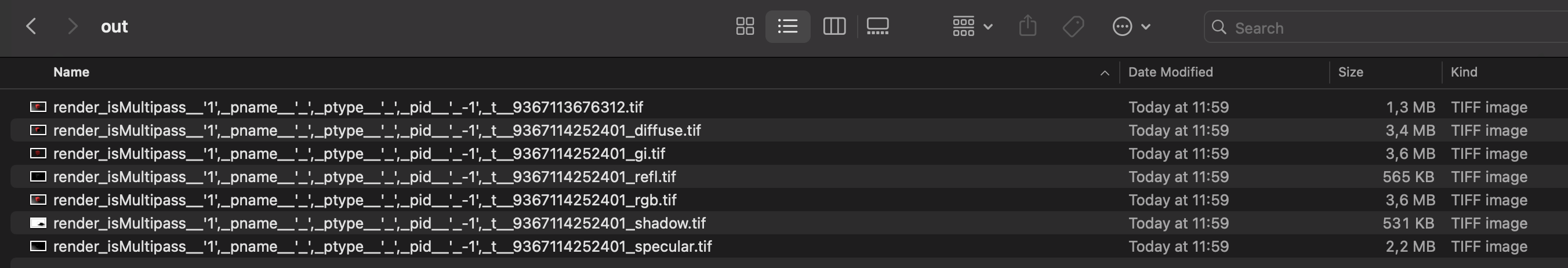

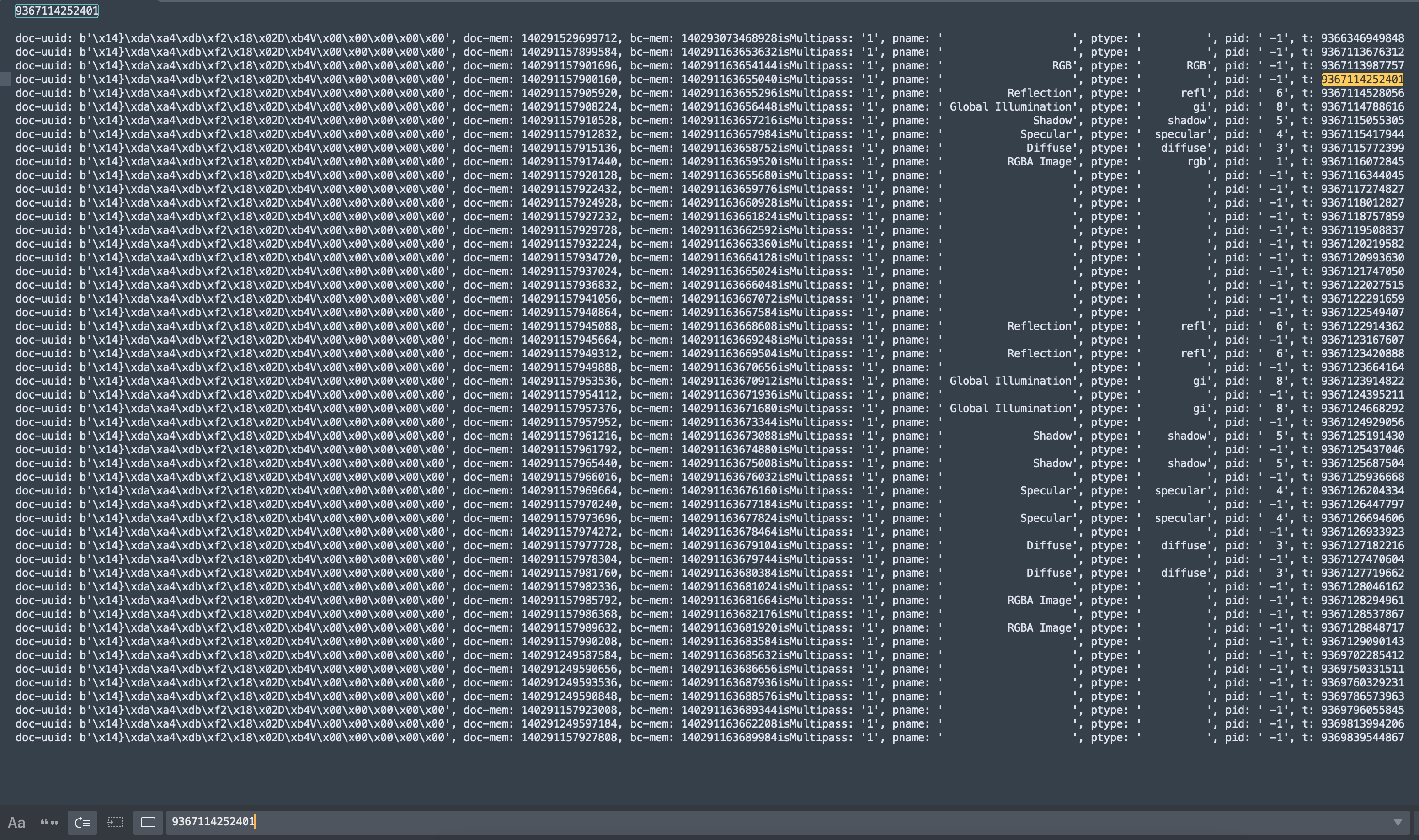

            Written Files:
            My console dump, here I search for the time stamp 9367114252401 of my files, it is the fourth call, long before we get the calls for the passes. The only thing that comes before is a call for the RGB, i. e., the beauty pass.
